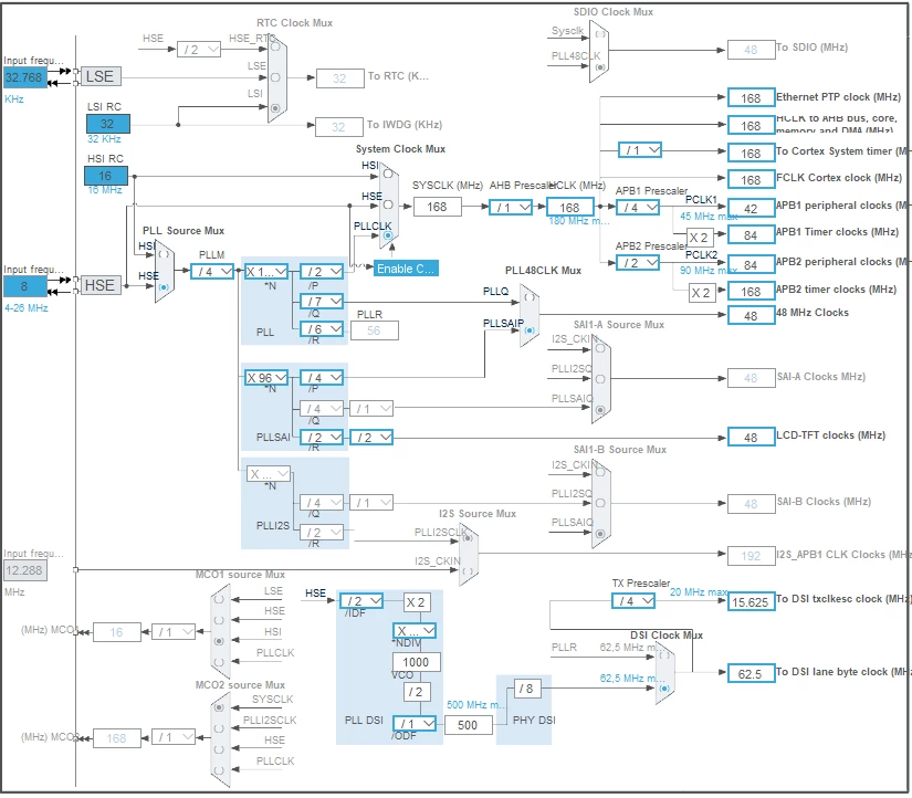

I am developing firmware for the STM32F7469I discovery board, and I'm utilizing TouchGFX for the GUI aspect of the project. However, I am encountering a problem when enabling USB-FS HOST functionality. The GUI and other peripherals such as UART and I2C are functioning correctly. However, as soon as I connect a device to the USB port on the discovery board, the device is in START state, but subsequently, the entire board freezes. Specifically, the USBH_UserProcess callback is invoked, and the HOST_USER_CONNECTION line is executed, but afterwards, the system becomes unresponsive.  The device doesn't go into ready state.
I am set proper clock, i have attached the image of my clock setting.
I would greatly appreciate any insights or potential solutions to address this deadlock issue.

Hi @tejashwini
Did you ensure that there are no conflicts with other peripherals? Have you tried the example CDC Host provided here ?
Does your USB code work on its own - without all the "GUI and other peripherals such as UART and I2C" ?
Jan 28, 2025 3:41 AM UTC
my TouchGFX only code is working fine and also USB CDC HOST only code is also working fine.
But in combining both the usb host is not going into ready state.
Please suggest some reasons and solution why it is not getting ready
Thank you

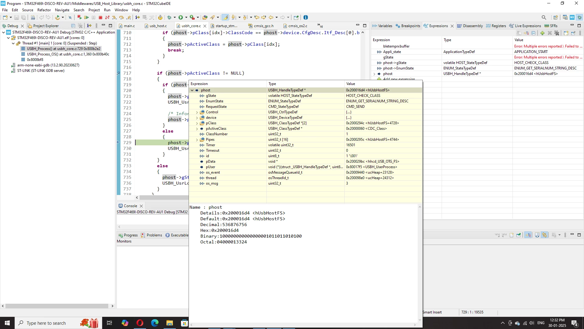

I am getting
phost->gState = HOST_ABORT_STATE;
USBH_UsrLog("Device not supporting %s class.", phost->pActiveClass->Name);
and host is moving into abort state.
I have attached debug trace at that particular line.
