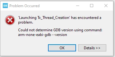

I would like to provide some more information about the issue that i signalled during yesterdays workshop. Hopefully these will help to get a solution.
When trying to debug an example projet in the CubeIDE I get the following error:

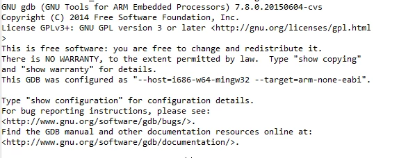

0693W00000DmVD4QAN.pngHowever, when I open a new Command Shell Console in the IDE and type the command "arm-none-eab-gdb --version" i get the following answer:
0693W00000DmVCaQAN.pngOther helpfull information:
  • Windows 10,
  • Tried reinstalling to default directory as @Jocelyn RICARD​ suggested
  • I have tried to force the use of other toolchains via Preferences->STM32Cube->Toolchain Manager. It didn't help
  • I am using another IDE with different versions of arm-none-eabi on the same computer
Is there maybe another method to solve my issue?

So, it does not seem to point to the same version.
I guess some path setup in your system take precedence to the one used by STM32CubeIDE.
Maybe you could check your PATH variable.
When I open a simple command shell, arm-none-eabi-gdb.exe is not found.
