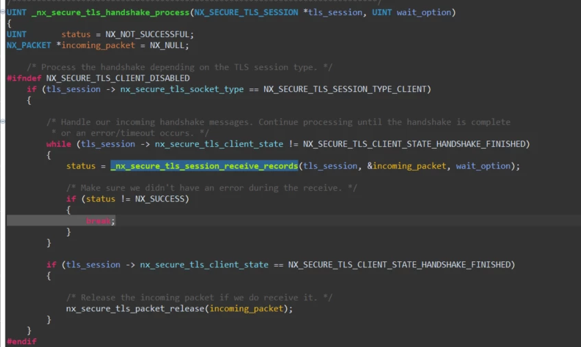

I'm trying to setup TLSv1.3 using STM32H63 Nucleo board. I followed the steps in https://github.com/eclipse-threadx/rtos-docs/blob/main/rtos-docs/netx-duo/netx-duo-secure-tls/chapter3.md to enable TLSv1.3 in STM32CubeMX. But all I get from the OpenSSL server is:
ssl.SSLError: [SSL: NO_SUITABLE_SIGNATURE_ALGORITHM] no suitable signature algorithm (_ssl.c:1006)
How do I solve this? I checked with the debugger and I can see that this code gets hit
#if (NX_SECURE_TLS_TLS_1_3_ENABLED)
 if(tls_session->nx_secure_tls_1_3)
 /* Send supported TLS versions extensions (for TLS 1.3). */
 status = _nx_secure_tls_send_clienthello_supported_versions_extension(tls_session, packet_buffer, &length, &extension_length, available_size);
 if(status != NX_SUCCESS)
 return(status);
Using wireshark I can see that clienthello from the client

which results in a handshake failure

Hi
Thanks for the reply, I made some progress by using ECDSA certs. Now I get a different error after server hello in the openssl server
100000000A000000:error:0A000438:SSL routines:ssl3_read_bytes:tlsv1 alert internal error:ssl/record/rec_layer_s3.c:865:SSL alert number 80
shutting down SSL
CONNECTION CLOSED
ERROR
shutting down SSL
CONNECTION CLOSED
 While debugging I can see this
With status values of 0x20007.
I checked if the server can be connected using openssl client mode
openssl s_client -connect 192.168.1.15:6000 -cert certsv2/client.crt -key certsv2/client_key.key -CAfile certsv2/rootca.crt -tls1_3 -sigalgs "ECDSA+SHA256"
and it seems to work with that.
Is there some other NetXDuo thing I'm missing?
Guillaume K
Sep 19, 2024 12:00 PM UTC
Status value 0x20007 could be NX_CRYPTO_PTR_ERROR defined in nx_crypto_const.h.
It looks like an incorrect netxduo configuration in the code running on the STM32.
How is the memory allocated ? is there enough memory for a TLS network stack ?
It's difficult to understand the root cause without the full project sources you are using.
Did you modify an example provided in Cube H5 package ? (Nx_IPerf, NX_UDP_echo_client, ...)
The full ServerHello packet details from wireshark , and the full openssl s_server trace (with -trace option) could help.
