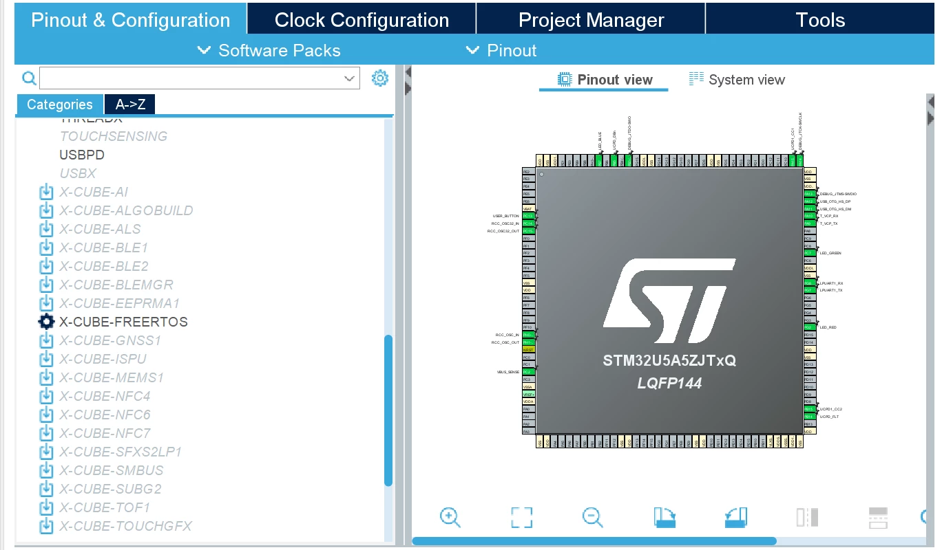

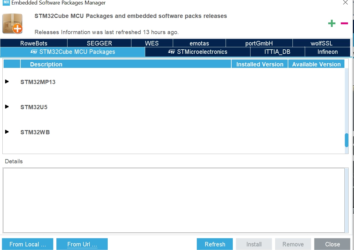

I'm working on a project with an STM32U5 device (NUCLEO-U5A5ZJ-Q) and I need to integrate cJSON, mbedTLS, lwIP, and FatFS to load and flash a configuration file cacert.pemonto the STM32 device. However, when I searched for mbedtls and lwip in the middleware and software packages, I couldn't find them.
Can anyone provide suggestions or guidance on how to integrate mbedtls, lwIP, and FatFS into my STM32 project? Additionally, I'm curious if there's a cJSON library available for STM32.

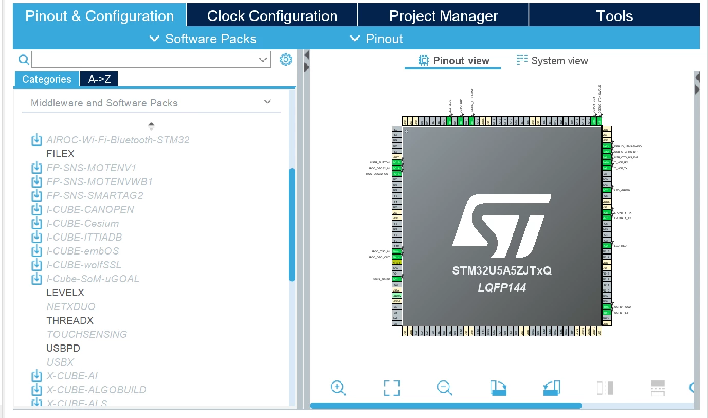

Hello @srikanthpalvai ,
In fact MbedTLS is well supported in the STM32U5 series and it's part of the TFM solution implementation as you can find in the TFM project under TFM_SBSFU_Boot alt_xx.c files which leverage the wrapper layer of MbedTLS to be HW accelerated which are part of The PSA cryptography API that provides access to a set of cryptographic primitives .MbedTLS can be found under STM32CubeU5/Middlewares/Third_Party/mbed-crypto at main · STMicroelectronics/STM32CubeU5 (github.com).
Regarding the support for  lwIP it is not supported for the U5 series instead you can replace it by the NetXduo from AzureRTOS you can find some examples of Netxduo Under STM32CubeU5/Projects/B-U585I-IOT02A/Applications/NetXDuo at main · STMicroelectronics/STM32CubeU5 (github.com)
FatFS is replaced by Azure FileX you can find a n example on it's implementation under STM32CubeU5/Projects/B-U585I-IOT02A/Applications/FileX at main · STMicroelectronics/STM32CubeU5 (github.com).
in the U5 series the Middleware Package is centered on the Azure middleware ecosystem you can read more about it in the Azure official documentation .

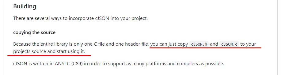

@srikanthpalvai wrote:
 Is there any cJSON library available for STM32?
Why would it be in any way specific to STM32 ?
Surely, it's just about parsing text - which isn't going to rely on anything STM32-specific?
You can simply dump the source into your project:
https://github.com/DaveGamble/cJSON
