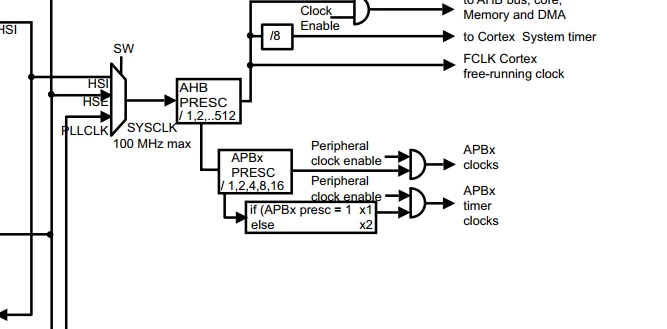

Regarding Bob S' comment, we're using the TIM_TypeDef provided by ST, which does declare the registers volatile.  Regarding "Aren't the 32bit timers on a slower bus?"  On the F411, no, the 32- and 16- bit timers collectively are on separate APBs but all of them get the same clock source.
That diagram is misleading. There are two APB buses, and timers on each of them have their separate clock setting, depending on the given APB prescaler.
Even if the resulting timer clock is equal for both buses (thanks to the "if divider > 1, timer clock is 2x" mechanism), the exact timing between several accesses to TIM registers from processor depends on the APB bus speed/divider. With non-1 divider, the access may be slower than 2 cycles, given that inter-bus synchronization gets activated (with undocumented timing). At the typical 100MHz setting, APB1 bus where the 32-bit TIM2/TIM5 sit is max. 50MHz so its clock gets divided and accesses to TIM2/TIM5 may be slow enough to cover up the above effect; as opposed to APB2 which is max. 100MHz and there's no division, and where the 16-bit TIM9/10/11 sit.
