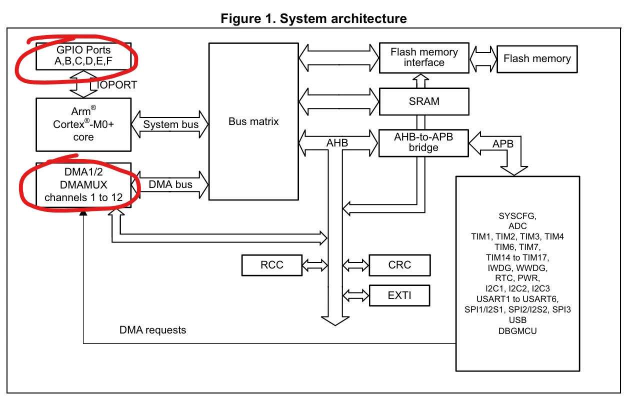

Timer triggered DMA Memory to GPIO output on the STM32G070RB
Hello, I have used DMA for timer outputs, input compares, memory to memory, etc. and all has worked fine, however I can't seem to get a timer-triggered DMA from memory to GPIO outputs (as this post seems to have managed).
I have tried using the ODR register, the BSRR register, 16 bit transfers, 32 bit transfers, reordering the initialisation of different components, setting TIM1->DIER = TIM_DIER_UDE in different places, etc. etc. The timer is definitely incrementing and resetting correctly and I am getting a TEIF1 on DMA1.
I am less familiar with DMAMUX (I used the F401 previously) so I may be making a mistake there.

TDKBest answer
Mar 13, 2026 1:09 PM UTC
This can't be done. The GPIO ports are not accessible to the DMA on the STM32G0x0.

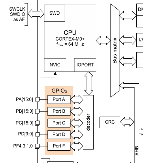

robert-m-lucas
Mar 13, 2026 1:10 PM UTC
Do you know where this can be found in the datasheet / reference manual, so that I can check whether other CPUs support this?
Mar 13, 2026 1:13 PM UTC
Search for "system architecture" in the Reference Manual.
robert-m-lucas
Mar 13, 2026 1:14 PM UTC
I misread this as being connected to AHB 🤦
