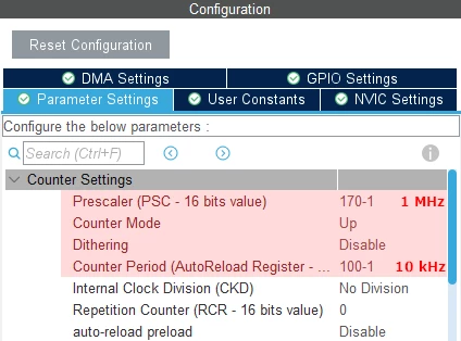

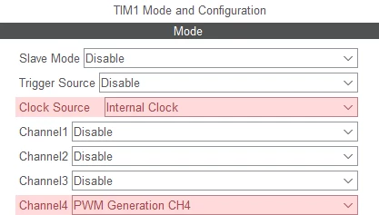

  • Clock SYSCLK/HCLK: 170 MHz
  • TIM1 CH4 configured
    • Prescaler: 170-1 => 1 MHZ
    • Counter Preiod: 100-1 => 10 kHz

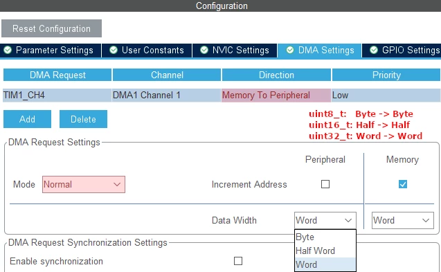

  • DMA
    • Memory -> Peripheral
    • Data Width: Word (32 bit)
  • 6 PWM pulses (= 600 us) should be sent out
TIM1 Mode + Configuration

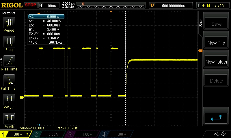

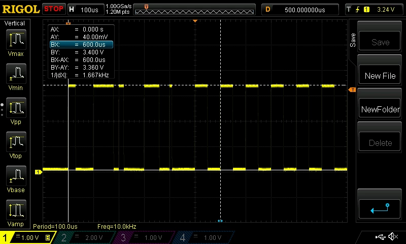

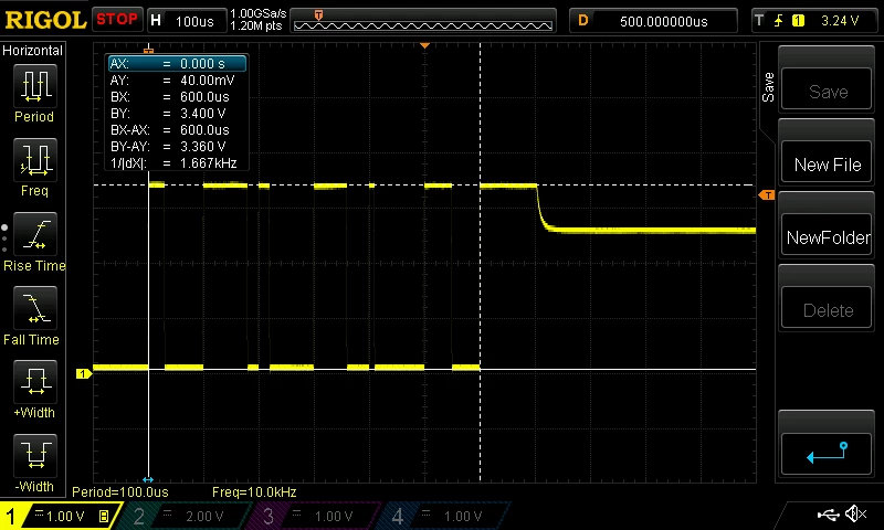

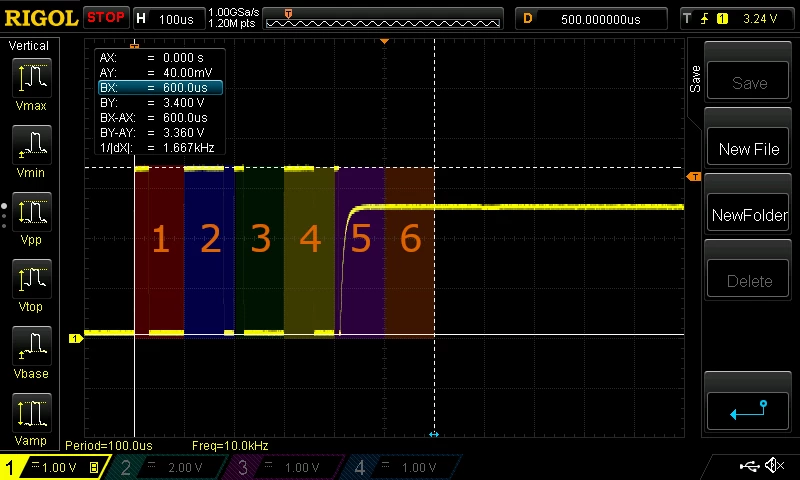

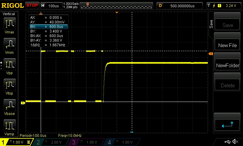

The result is here:
After 4 pulses, the 5th pulse starts but didn't finish
I tried also with Data Width
Half-Word
Byte

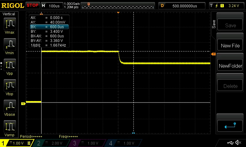

Without stopping DMA, it's like that:
The last puls recurs:

The SPI-(or UART-)based solution may be better, but the problem with the timer-based solution is, that you call a function which disables the timer output (i.e. threestates it), as witnessed by the oscilloscope track. Just don't do that. Some Cube/HAL functions may not do what you think they do just based on their name - pending more thorough documentation, they are open source so you can easily look up what are they doing, or just don't use them and program the microcontroller normally.
Here, you don't want to *stop the DMA*. Unless set to Circular, DMA stops automatically when it transfers all data it is set to transfer (in its NDTR register). What you want is a steady output from TIM, and one easy way to achieve that is by setting the respective TIMx_CCRx to zero. So, simply add one zero as an extra element in the array you are transferring using DMA to TIMx_CCRx.

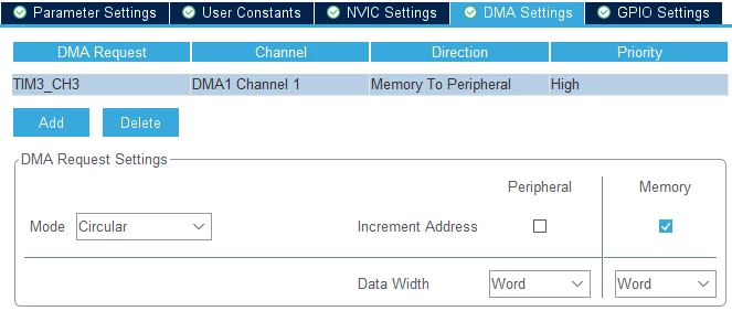

I looked at the example TIM_DMA
STM32CubeG4/Projects/NUCLEO-G431KB/Examples/TIM/TIM_DMA at master · STMicroelectronics/STM32CubeG4 · GitHub
Here it uses circular mode, not normal mode (and another timer, TIM3_CH3):
And the period is computed at compile or runtime rather than using the "Device Configuration Tool":
  • Clock SYSCLK/HCLK: 150 MHz
    • Prescaler: 0 => 150 MHZ

In my example above, I send 6 PWM pulses, but after the 4 pulse, the 5th pulse starts but didn't finish. There is no 6th pulse anymore. So HAL_TIM_PWM_PulseFinishedCallback() comes too early, not after the 6th pulse but at the start of the 5th pulse and stop the DMA too early.
I don't care it the timer starts LOW and ends HIGH.

  • HAL_TIM_PWM_Stop_DMA() disables the peripheral and threestates it, maybe with the macro __HAL_TIM_DISABLE(). I'm not sure.
HAL_StatusTypeDef HAL_TIM_PWM_Stop_DMA(TIM_HandleTypeDef *htim, uint32_t Channel)
 /* Disable the Peripheral */
 __HAL_TIM_DISABLE(htim);
  • In DMA Mode "Normal" the DMA stops after the specific count. Because I didn't use 0 but 50 as the last pulse, the DMA stopped but the TIM_CH4 stays with the last pulse forever.
  • Add one zero as the last pulse solves the problem

The oscilloscope gives the result
It's just strange that HAL_TIM_PWM_PulseFinishedCallback() comes 2 pulses to early. But if no one helps me, I'll just have to live with it.
