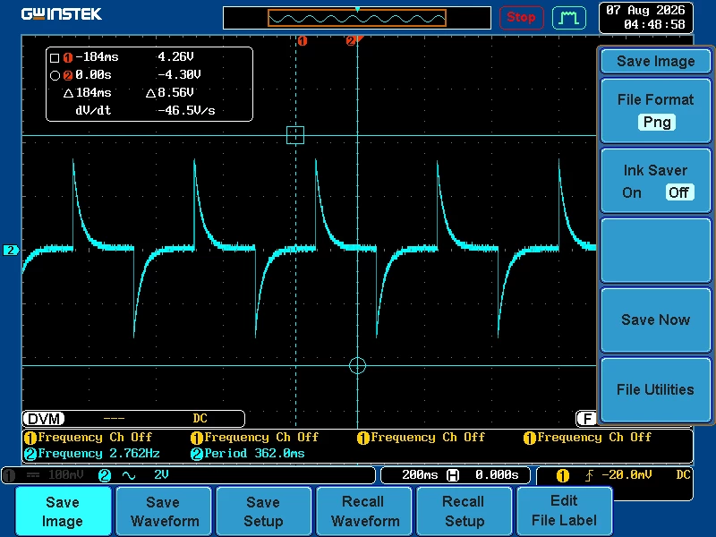

I am using stm32f429zi for my project, I set timer 1 with 4 channels (channel 1 and 2 as input channel, and channel 3 is output channel). I would like to generate a pulse from channel 3 with low frequency and around 50% width to set a communication handshake signal to different control board. I set main frequency as 168MHz, so timer 1 APB2 is 168MHz. the setup is followed:

However, after I start my program, I got the following result:
the pulse is not square pulse, the output voltage drops right away after comparator result trigger preset value and toggle output. Does anybody know how to fix this issue? Do I need use pulse output instead of toggle output mode.
thank you.

AScha.3
August 7, 2026

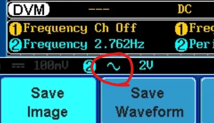

this pic is obviously not a DC-coupled signal, its AC coupled.
So check connection or try other scope probe ...or switch to DC . :)
August 8, 2026
This symbol means the channel is in AC coupled mode. Switch it to DC coupled.
This is a scope setting issue, not a STM32 problem.
