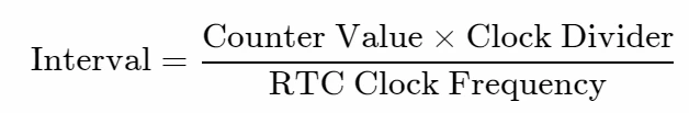

Hello @curiae,
The formula to calculate the wake-up timer interval is:
given:
  • Counter Value = 102
  • Clock Divider = 16
  • RTC Clock Frequency (assuming LSE clock) = 32.768 kHz
So, yeah it should be around 50 milliseconds trigger, what's the clock source being used?
Regarding the Systick behavior, -if I understood correctly- it is important to note that when the MCU enters Stop mode, the SysTick timer is stopped. This is because the SysTick is typically driven by the system clock, which is halted in Stop mode to save power.
