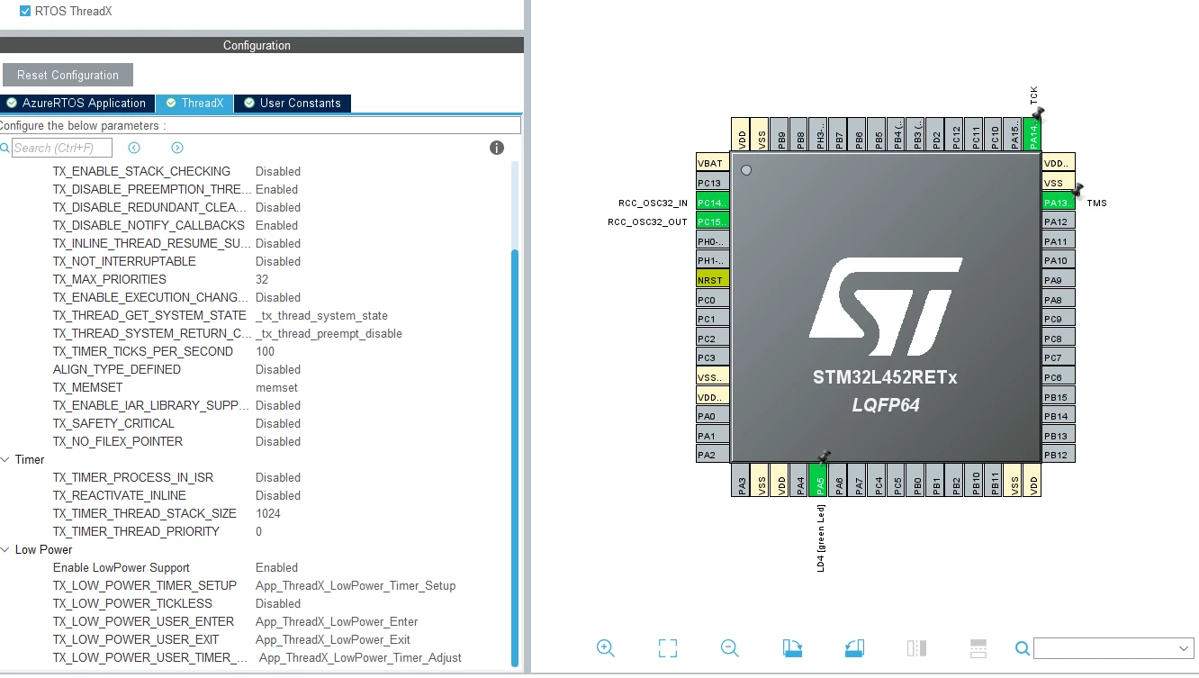

ThreadX with stop mode 1 works fine after power reset, but fail on run and debug.
I have completed the code and uploaded it to the following GitHub repository: https://github.com/gamarrita/Nucleo-L452_Azure_RTOS/tree/master/01_stop_mode_1
In my code, I am using the RTC and its wakeup capability to control sleep time. I am only using one thread, which sleeps for 5 seconds and then wakes up to sleep again.
The code works fine if I turn the power off and on again, but the CPU keeps entering and exiting a very high frequency if I just press the run or debug button.
Why stop mode works fine in one situation and fails in others?
And more important, how I can figure out, debug technique, to find out what is making CPU wakeup?

Unlike FreeRTOS, which have and "IDLE Thread" that is activated when no other threads are, ThreadX is blocked at the scheduler until a thread is ready.
for the HAL_DBGMCU_DisableDBGStopMode(), as said, it is useful to be sure that the system entered the STOP mode as it may happen that a pending IRQ interferes with the system and wakes it up. so the behavior is expected as the IDE looses connection to the target.
Now as you are sure that your application enters/exits the STOP mode correctly you can remove the call to that API and the debugger will continue to work correctly

In may application has one thread which performs the following:
Turn led on -> tx_thread_sleep(20) -> Turn led off -> tx_thread_sleep(100)
  • LPTIM 1 is free running, LSE 32768, I am using it to measure time elapsed during sleep.
  • RTC will wakeup CPU in tx_low_power_next_expiration ticks
I added the debug message "x_low_power_next_expiration"
I was expecting to receive the following sequence of messages:
20 ... delay of 20 ms
200 ... delay of 200 ms
and repeat for ever
But I got
19 ... delay almost 20ms
0 ... almost no delay
(a total of 14 zeros with almost no delay)
199 ... delay almost 200ms
I understand where the difference of 1 comes from, but I don't understand why the zeros that are between these values?
The CPU is actually going into sleep mode for 20 and 100 ticks in each case.
