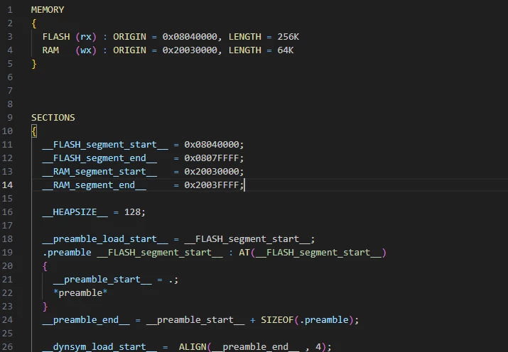

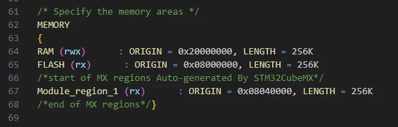

For those following along, I have been able to resolve this by implementing a few things.
  1. I have taken the sample linker file for the module editing to the correct memorydbit_0-1751450223532.png
  2. I have added the `gcc_setup.s` to my application sourcesdbit_2-1751450266246.png

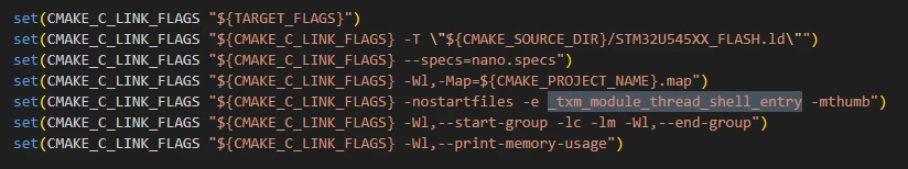

  3. I have amended the `gcc-arm-none-eabi.cmake` to not attempt to link in a main or an `.init` into the map file by adding `-nostartfiles -e _txm_module_thread_shell_entry` to the C link flagsdbit_3-1751450293914.png

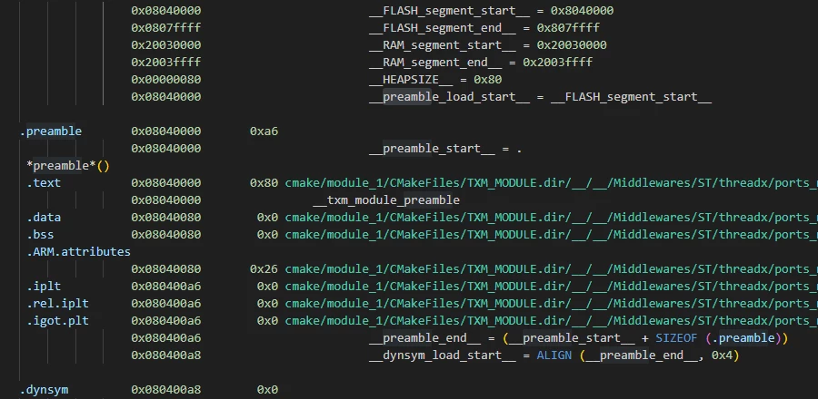

This allowed me to load into the correct part of memory with the preamble being populated at the start of the memory section
To do so I have had to split my project such that two linker files are separately used, two elf files created and flashed one after another.

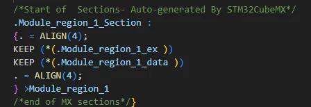

I have in my linker already:
to the corresponding region:
Then above every method and global I have the relevant attribute:

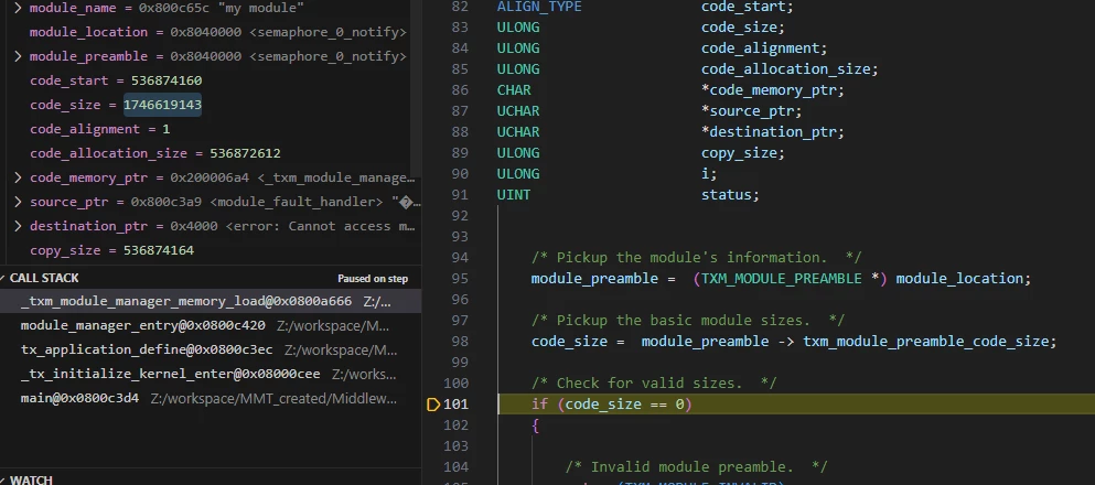

This allows the Module region to be populated:
However my module does not get loaded properly by the manager as it does not read the length of the code properly.
Do you know why this could be?

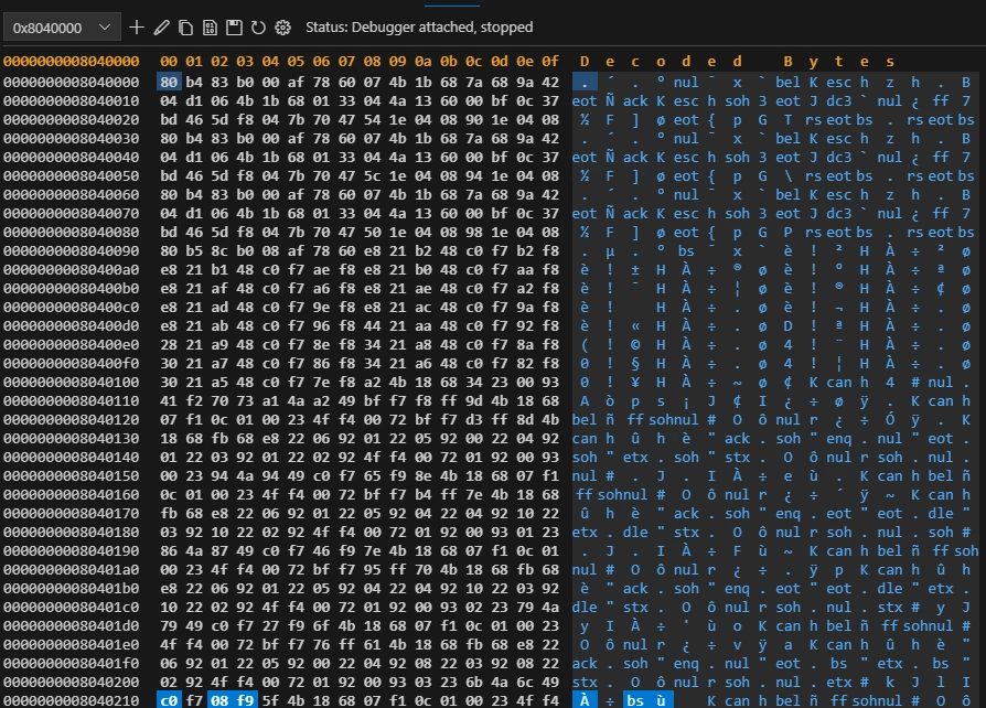

Jun 27, 2025 9:52 AM UTC
As an extra, this is the memory within the section that I have loaded my module into:
