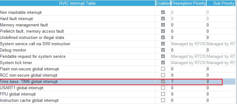

I think you can resolve your issue by setting priority 14 (less than 15) to TIM6 in NVIC.

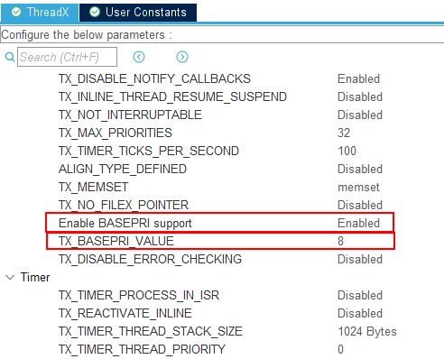

Haithem Rahmani
Feb 14, 2023 4:01 PM UTC
Hi @Community member​
Sorry for the delay.
Indeed you can configure this via STM32CubeMX as below.
  1. Enable the BasePRI support in the ThreadX config panel, then set the BASEPRI value to "8" for example as shown below:
0693W00000YAiBdQAL.png 2. go to the NVIC config panel and set the TIM interrupt priority to any value greater than "8"
0693W00000YAi1uQAD.pngdoing that the threadx will not mask the TIM 6 any more, but this may impact the overall behaviour of you application as each 1ms a TIMER interrupt will be received and needs to be managed.
regards
Haithem.

I had the same issue with the STM32U5A5 Eval board, where HAL-Delay() seems to run strangely when ThreadX goes to standby with peripheral interrupts disabled (is this a correct assumption?). I fixed this by pushing TIM6 to priority level 14 from 15 and enabling BASEPRI Support with level 15. I wonder if there are certain guidelines or good practices to determine the correct setting.
