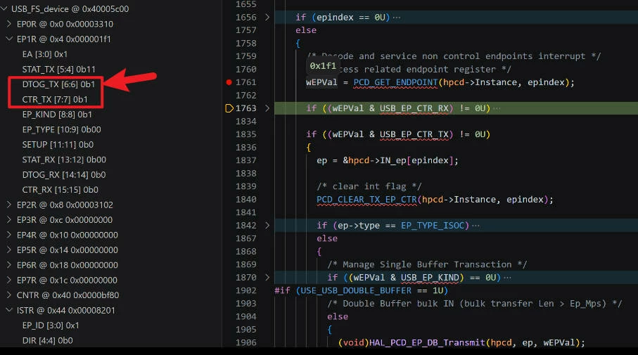

The STM32G431 API of USB double‑buffer transmit‑complete interrupt processing contains a bug.

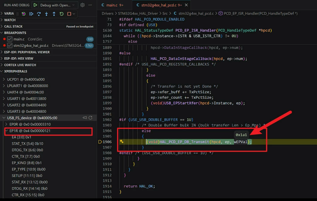

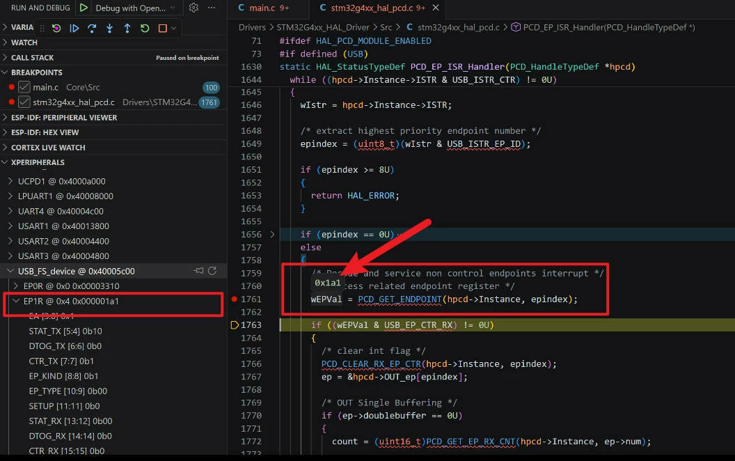

After I configure EP1 to the double‑buffered mode, debugging reveals an issue inside stm32g4xx_hal_pcd.c. At line 1761, the endpoint register value is read. After executing PCD_CLEAR_TX_EP_CTR(hpcd->Instance, epindex); to clear the interrupt flag, the actual register content has already been updated. However at line‑1906, (void)HAL_PCD_EP_DB_Transmit(hpcd, ep, wEPVal); still receives the register value captured before interrupt‑flag clearing. This triggers incorrect conditional judgements inside the HAL_PCD_EP_DB_Transmit() function.
Probable root‑cause: When transmitting data for the first time under double‑buffered setup, USB_EPStartXfer populates both buffers by default. After Buffer‑0 finishes transmission and triggers an interrupt, the program reads register data at line‑1761 of stm32g4xx_hal_pcd.c. Right after this read operation, Buffer‑1 also completes its transmission and updates the endpoint register. Since HAL_PCD_EP_DB_Transmit uses the stale register value obtained earlier rather than the latest value, abnormal behaviour occurs.

captured endpoint register value
The input value is inconsistent with the actual current value.

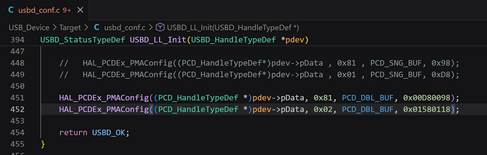

I regenerated a CDC‑based project with CubeMX and re‑assigned endpoints: EP1 for CDC‑CMD, EP2 as the IN endpoint and EP3 as the OUT endpoint. EP2 and EP3 are configured in double‑buffered mode.

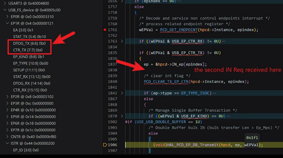

You can view the screenshots of my debugging‑trace here.

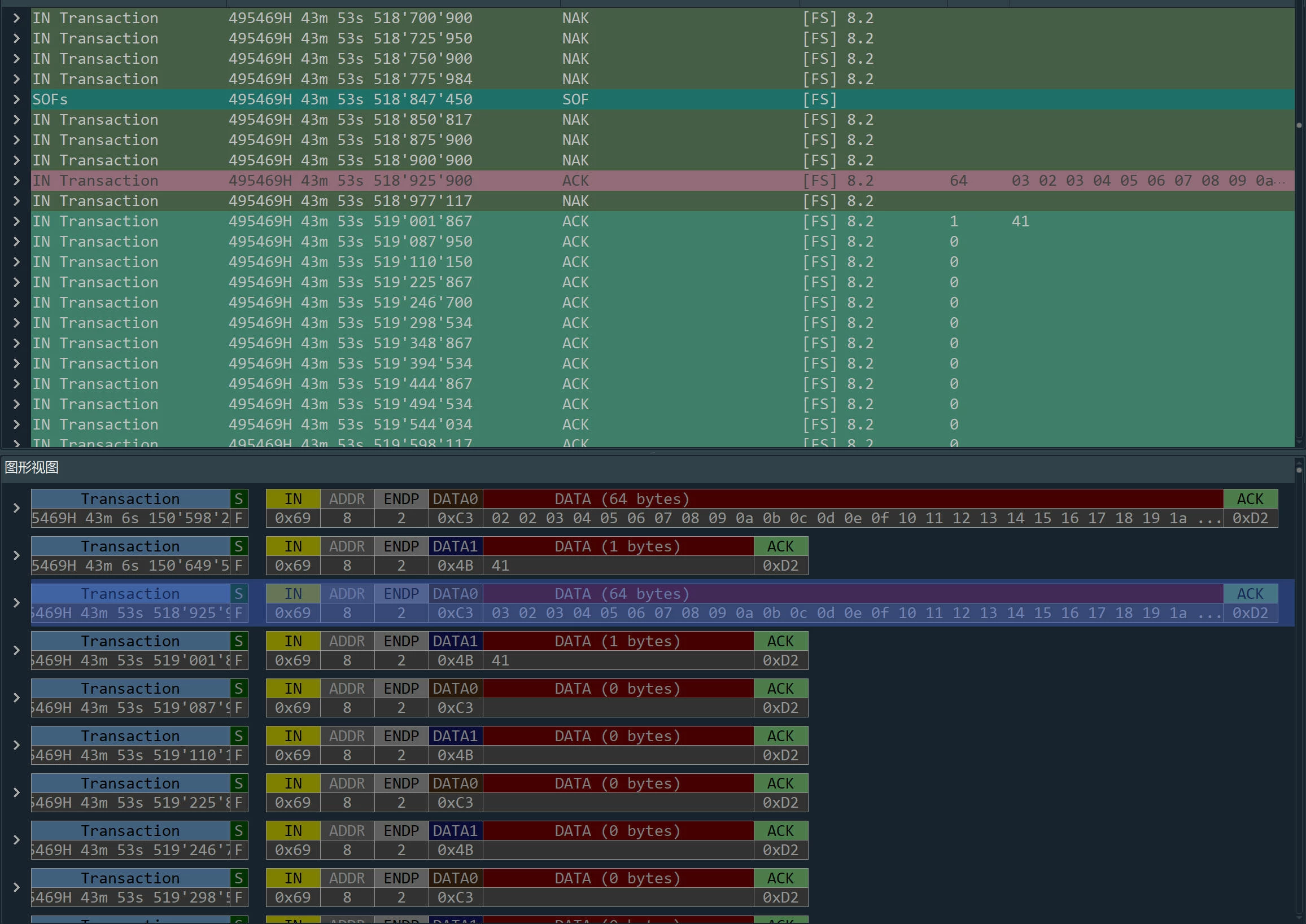

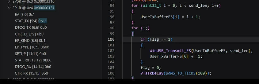

After I start debugging, I fill 65‑byte data into the double‑buffers via the WinUSB_Transmit_FS interface, with 64 bytes for buffer0 and 1 byte for buffer1, then wait for IN requests from the host.
When the first IN request from the host is received, a transfer‑complete interrupt is triggered, and the EP1 registers are configured with corresponding values. Everything up to this point works exactly as expected.
However, if the next IN request sent by the host arrives before executing PCD_CLEAR_TX_EP_CTR(hpcd->Instance, epindex); or HAL_PCD_EP_DB_Transmit(hpcd, ep, wEPVal);, the value of the EP1 register conflicts with the usbd driver library.
I’m not sure whether I explained this clearly, or if I have misunderstood the usbd driver‑library.

The USB‑CTR interrupt works properly. According to my previous screenshots, wEPVal acquisition and the call to PCD_EP_ISR_Handler take place within this interrupt.
It is fairly clear that the bug originates from the HAL library.

The proposed workaround is to re read the endpoint register immediately before it is passed to the double-buffer transmit handler:
/* Re-read the endpoint register right before using it below. */
WEPVal = PCD_GET_ENDPOINT (hpcd->Instance, epindex);
This is intended to prevent the handler from using a stale endpoint register snapshot when another IN transaction updates the endpoint during interrupt servicing. The fix is proposed and awaiting an official release.
