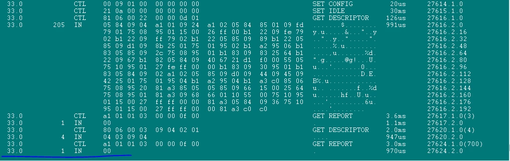

The questions about stm32f1 Usb-hid.The libs from TM32 USB-FS-Device Lib V4.1.0' Custom HID#Insert get report in RESULT CustomHID_Data_Setup/usb_prop.c
The original CustomHID_Data_Setup function :

If I don't change the original code:
The result of usb communication is this:c00000004 stall pid.I guess because original code not have handle "get report".My request in host by feature.

add to new function:
uint8_t *CustomHID_GetReport_Feature(uint16_t Length)
return (uint8_t *)(&report[0]);
uint32_t report[]={0x01,0x01,0x02,0x03,0x04,0x03,0x02,0x64,0x64,0x00,0x00,0x00,0x00,0x04};
But the device only responded with a data 0.
0693W00000aHo8XQAS.pngI don`t know why?

JachChen423
Feb 28, 2023 9:25 AM UTC
I forgot to add break, but stall pid=c0000004 appeared again.
gbm
Feb 28, 2023 2:28 PM UTC
uint32_t report[]?
The report is a sequence of bytes, not 32-bit words.

JachChen423
Mar 1, 2023 1:37 AM UTC
Thank you for your answer. Unfortunately, I still can't.

JachChen423AuthorBest answer
Mar 2, 2023 10:06 AM UTC
Now is OK.
if (Length == 0)
  pInformation->Ctrl_Info.Usb_wLength = Size ; //The size is your data length.
  return NULL;
 else
I don't know why.Because I think it had return.But it's ok.!!!???
