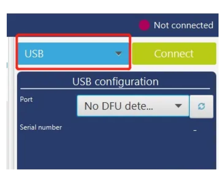

Does the Bootloader programme of STM32F4 series support multiple devices to be download at the same time?
2 replies
Tesla DeLorean
Guru
November 23, 2023
The loader doesn't care.
Each device presents as a USB DFU Device to the host with a name like "STM32 BOOT LOADER", expect them to be uniquely enumerated on the host PC
November 23, 2023
You can only connect to one chip at a time.
