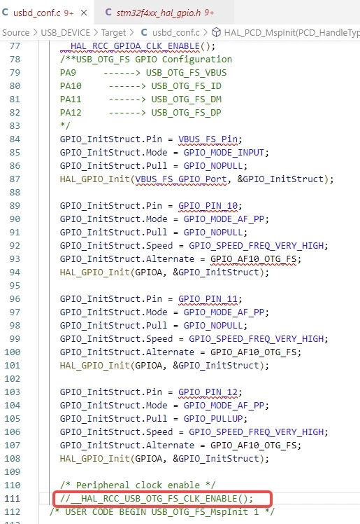

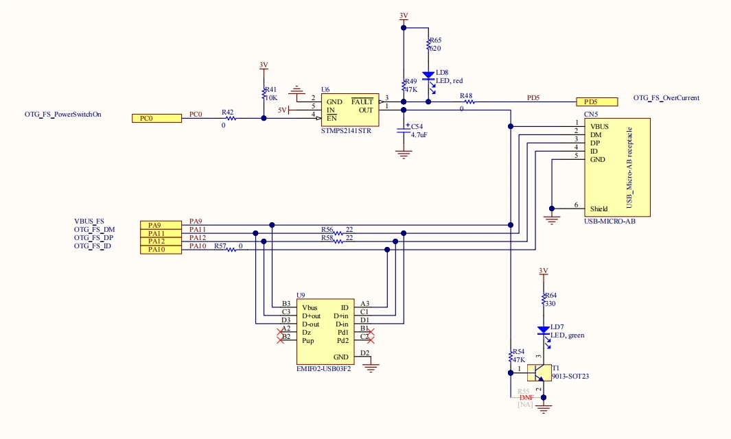

The PC cannot detect USB device access after downloading the USB demo generated in STM32F411E-DISCO(MB1115-F411VE-D01) development board using STM32CUBMAX
0693W00000aHNy2QAG.jpgUSB DP and DM have no 1.5k pull-up resistance, which will not take effect after internal pull-up of DP or DM (DP or DM grounded), and the resistance value of current limiting resistance (R56 R58) is 12.5 Ω instead of the marked 22 Ω
The measured value of PA10 after internal pull-up is 2.9V
(PA11 PA12) Measure 0.1V after internal pull-up

add info:
