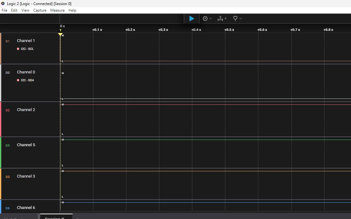

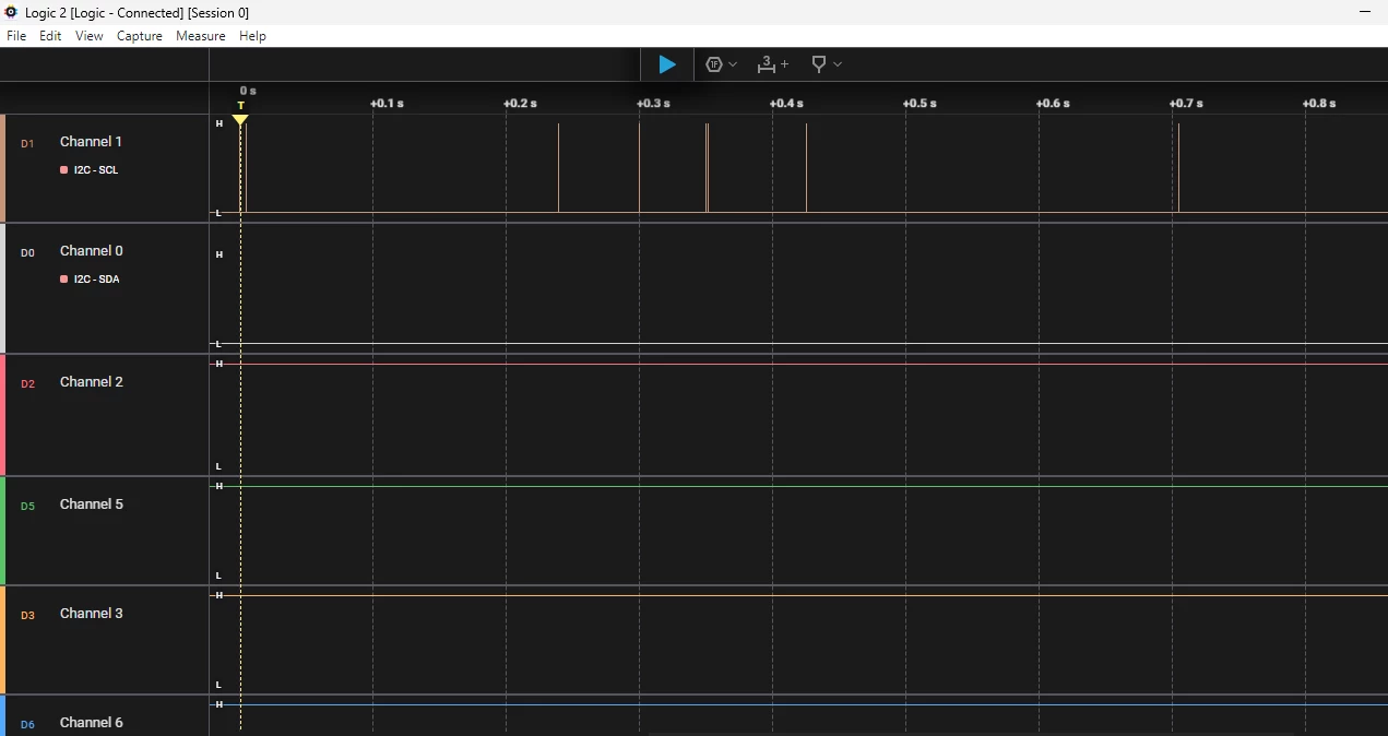

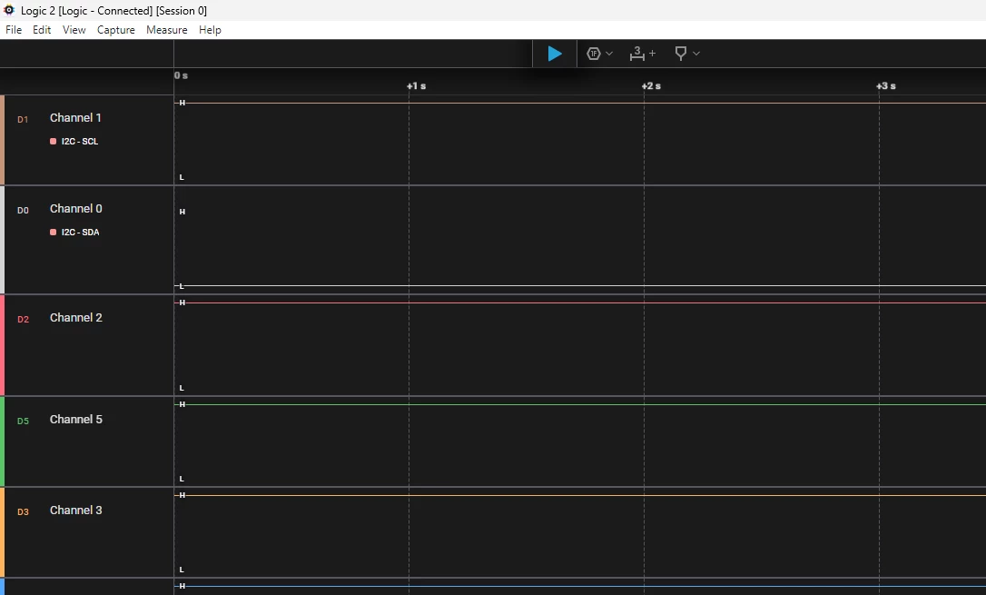

Hello Sir,
I’ve been dealing with an I2C protocol error for a long time, but unfortunately, neither the solutions online nor the suggestions here have been successful. I've changed sensors multiple times and tried different methods, but the problem remains the same. I’m using the STM32F413ZH board, and in my current tests, I’m using the QMC5883L model for I2C. The pull-up resistors are connected correctly. I even tried soldering the connections to improve them. I also attempted to supply power externally and change the cables, but the issue still wasn’t resolved.
I used a logic analyzer to monitor the bus, and either the signal gets stuck as shown below, or it works chaotically in a meaningless way. For example, SCL often stays high, while SDA changes continuously, or SDA stops entirely at certain points and then continues later. I've seen many variations like this, but it rarely works correctly. I mostly get error codes like 32, 36, and 544.(So it comes as 32 + 512, and in the HAL definitions, 512 is defined as an error of incorrect initialization. To be honest, I have no idea why I’m receiving 512.) I’ve tried the solution involving 9 clock toggles, as many people suggested, but that didn’t help either. I suspected the issue was with the STM32, so I tried it with an Arduino, but although it worked, it stopped after 30-40 seconds. Whatever I do, I’ve never been able to achieve stable operation.
There have been rare instances where the STM32 managed to make a single read, but it would then break again as I described. However, this happened very infrequently. At this point, I’m really starting to think that STM32 engineers have failed in handling this issue effectively.
I will now provide a few examples from the logic analyzer, the current code I'm testing, the values read, and the products I'm using.
I would like to thank in advance everyone who takes the time out of their valuable schedule to assist me with this issue.

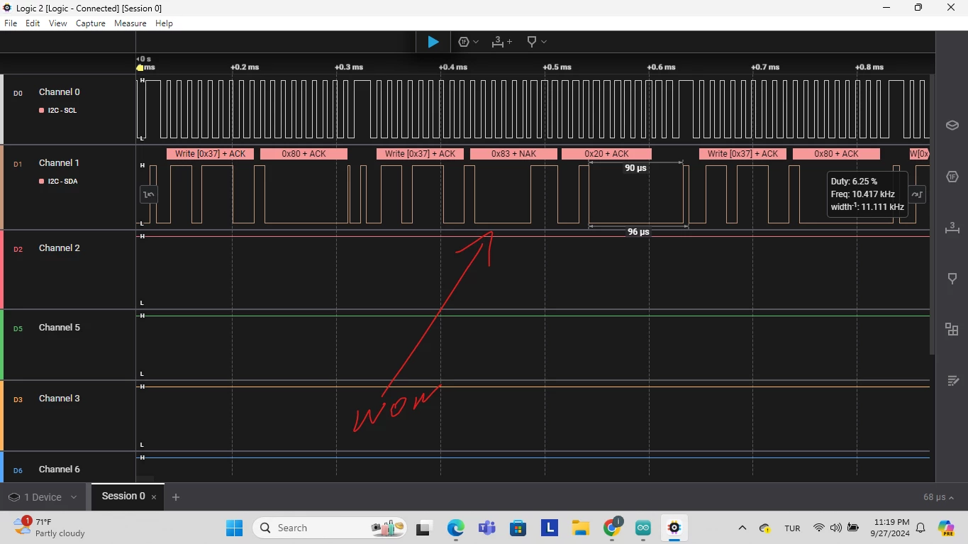

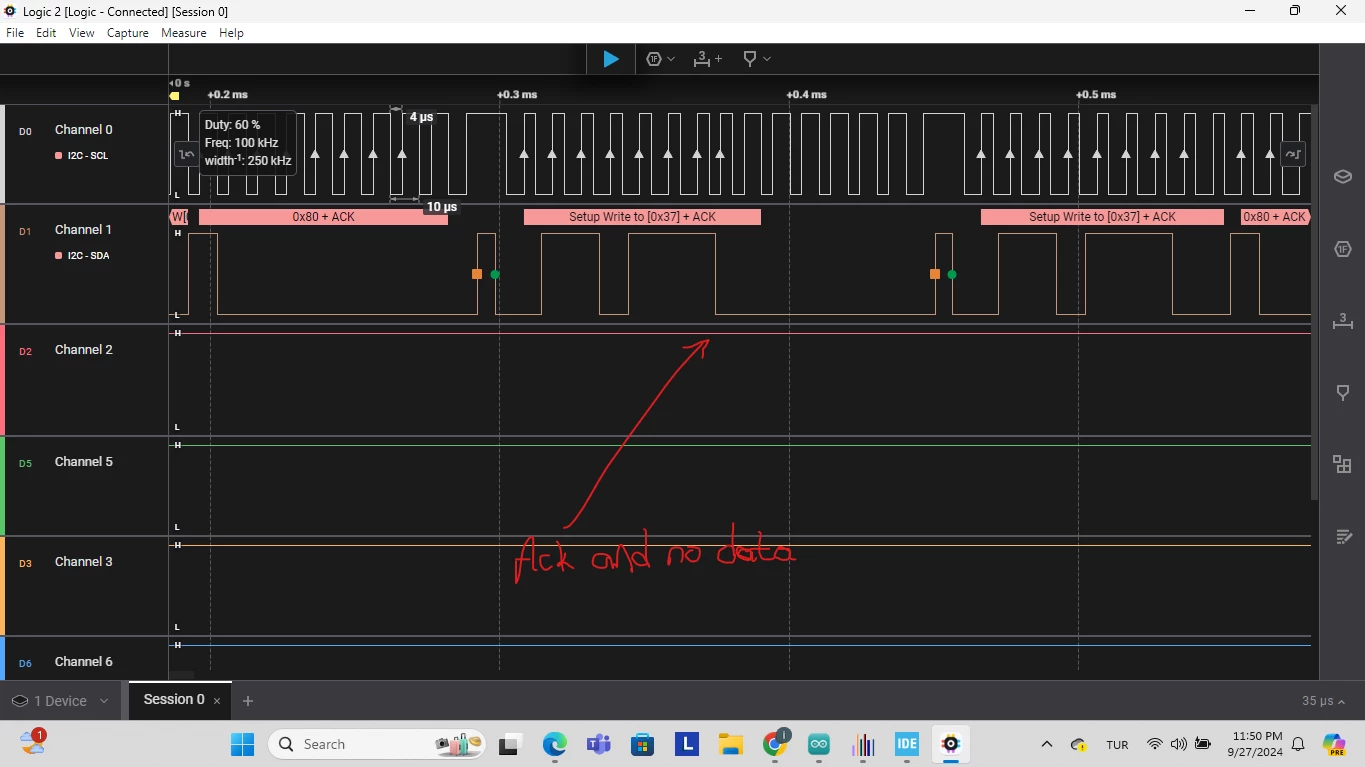

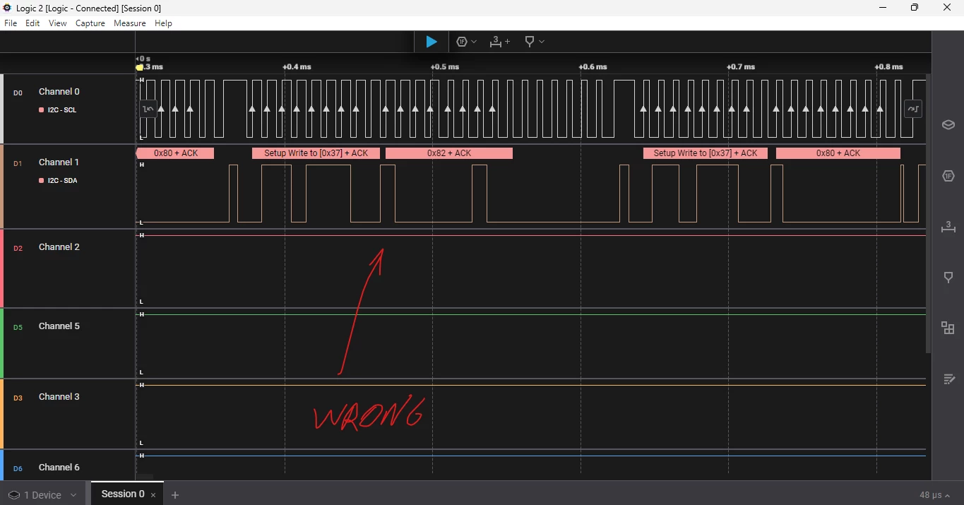

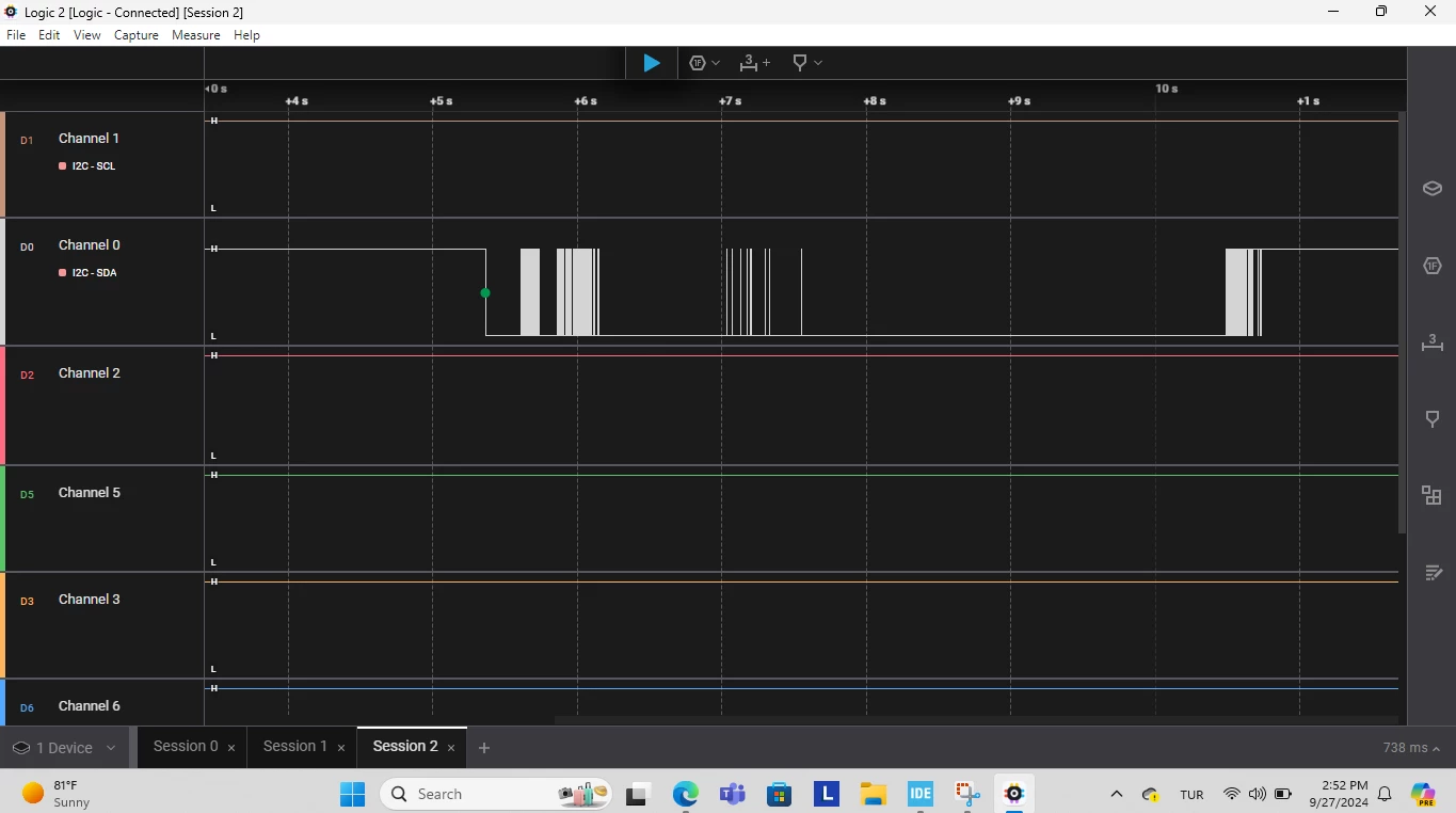

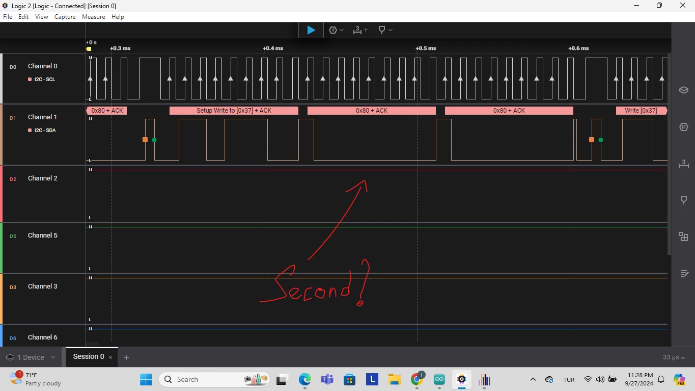

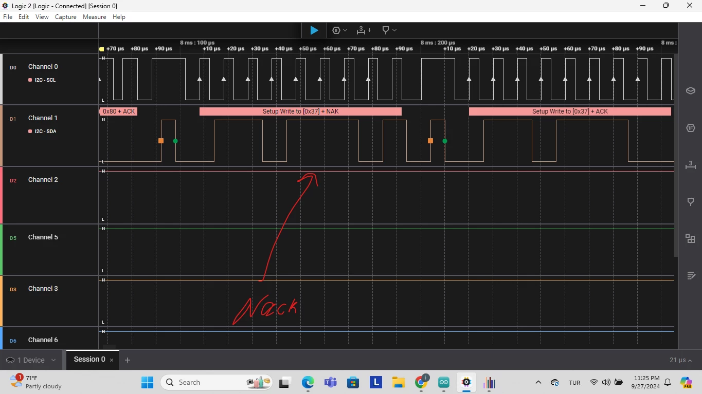

Signals captured within very short time intervals:

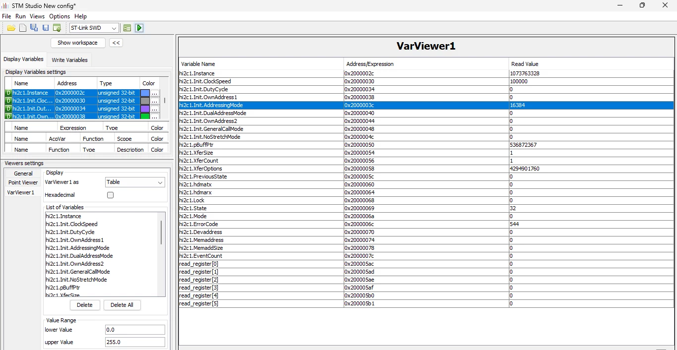

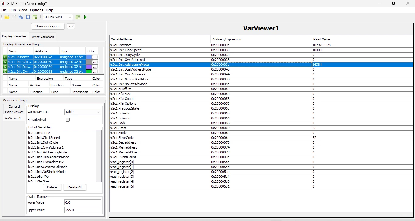

Values read from STM Studio at short time intervals:

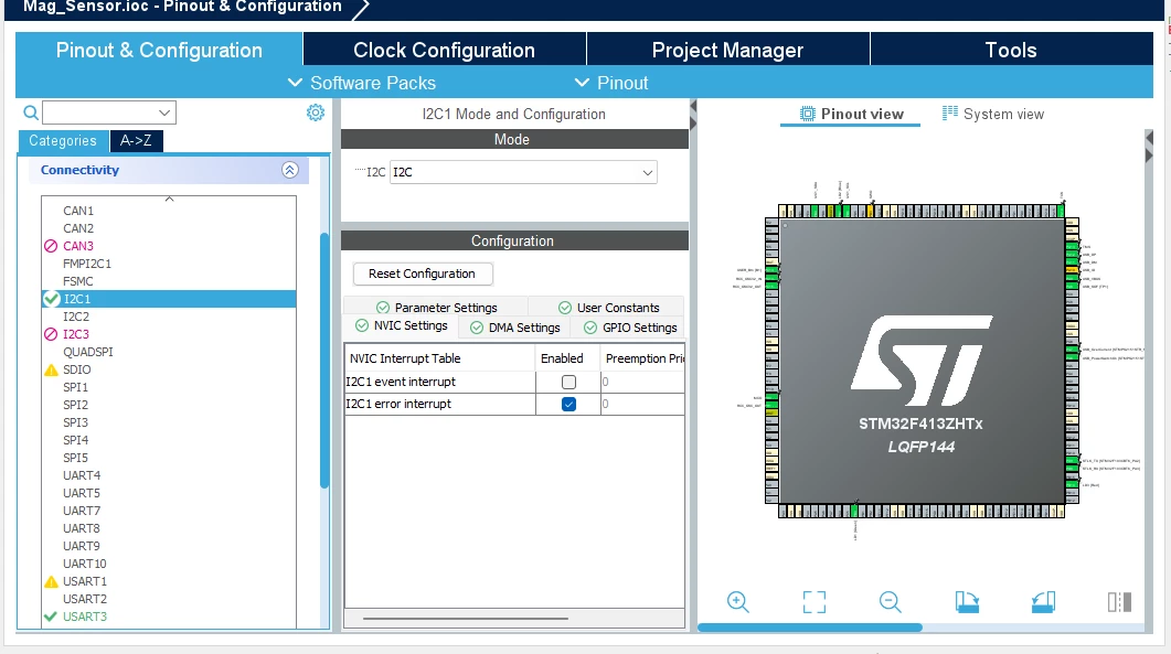

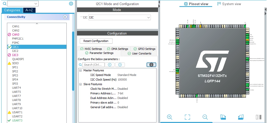

Configuration settings:

 hi2c1.Instance = I2C1;
 hi2c1.Init.ClockSpeed = 100000;
 hi2c1.Init.DutyCycle = I2C_DUTYCYCLE_2;
 hi2c1.Init.OwnAddress1 = 0;
 hi2c1.Init.AddressingMode = I2C_ADDRESSINGMODE_7BIT;
 hi2c1.Init.DualAddressMode = I2C_DUALADDRESS_DISABLE;
 hi2c1.Init.OwnAddress2 = 0;
 hi2c1.Init.GeneralCallMode = I2C_GENERALCALL_DISABLE;
 hi2c1.Init.NoStretchMode = I2C_NOSTRETCH_DISABLE;
 if (HAL_I2C_Init(&hi2c1) != HAL_OK)
 Error_Handler();

Related:
Always SCL High, SDA Low In I2C - STMicroelectronics Community
Can't solve hardware problems with software, at least not most of the time. Based on your plots and your description of the issue, it doesn't look like a software problem. SDA and SCL should be idle high after power on. If they're not, it is a hardware issue.

In my current test, I believe you're right. Even when I don't write any code to operate the line, the SDA line is being pulled low.
Sep 27, 2024 2:01 PM UTC
Doing an analog capture on SDA/SCL lines might be useful here. Even with it toggling randomly, you should see a slow rising edge and a fast falling edge as expected with an open-drain output. If they are both fast, something on there is misbehaving.
Still think the resistance test with a multimeter would be a good idea.
Could remove the external I2C slave chips to see if problem goes away. If I was stuck, that's what I would do to confirm the hardware issue.

Karl Yamashita
Sep 27, 2024 8:40 AM UTC
Let's make sure the QMC5883L is not the cause of the SCL/SDA lines staying mostly low.
First comment out your read/write routines and see if the SCL/SDA lines stay high.
If they either line go low, remove the QMC5883L and still comment out the I2C Mem read/write.
Be sure the pull-up resistors are still connected to the STM32.
Then run again to see if the SCL and SDA line stays high?
You can also connect two I2C ports together and test in loopback.
I’m receiving signals like this and similar ones, which make no sense, and moreover, the SCL line remains high as it should.
Thank you.

In your latest screen shot, is the QMC5883L connected?

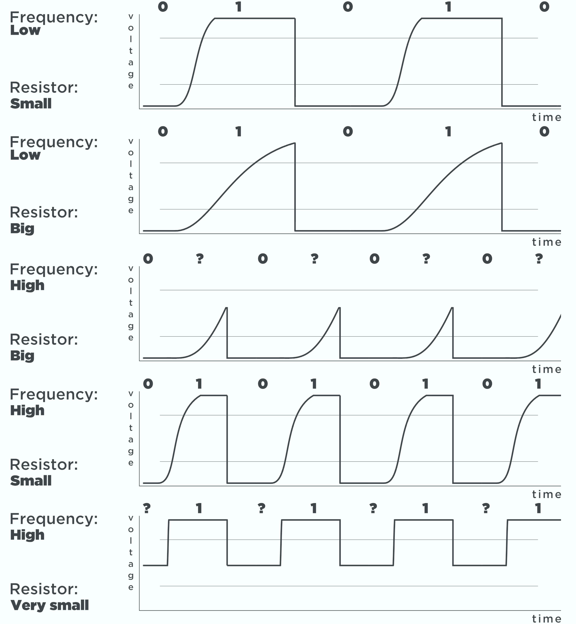

Andrew Neil
Sep 27, 2024 2:07 PM UTC
@AlexanderKibarov wrote:
Resistor value is 2.2K. Is it enough in your opinion?
Probably.
The way to check is to look at the waveforms with an oscilloscope.
See this post:
https://electronics.stackexchange.com/questions/1849/is-there-a-correct-resistance-value-for-i2c-pull-up-resistors/473799#473799
It contains this diagram - which shows you the effect of the pullup value:
https://community.st.com/t5/stm32-mcus-products/stm32f072v8t6-capacitance-and-rise-time-of-for-i2c/m-p/634079/highlight/true#M234042
#I2CPullupValue #PullupValue
AlexanderKibarov
Sep 27, 2024 9:10 PM UTC
@Karl Yamashita @Andrew Neil @TDK @LCE
Thank you once again for your valuable responses.
I am now certain that the problem is caused by the QMC sensor. In my tests, I successfully established I2C communication between Arduino-Arduino and STM32-Arduino, and the communication was flawless. As you mentioned, when I checked the resistors on the QMC, I saw that one was 2.2k and the other 0.3k. I then replaced it with a new QMC that had the correct resistors, but there was still an issue. (In fact, strangely, the device overheated and started smoking. This had happened to me before.) The connections were as follows:
* VCC-5V
* GND-GND
* SCL-SCL
* SDA-SDA
Although the overheating issue had occurred before, I still don't understand the reason behind it. As I initially mentioned, communication between Arduino-Arduino and STM32-Arduino was flawless, but sometimes the situation depicted in the image below occurred. Frankly, these are not major issues since they do not disrupt communication, and maybe these issues are due to the logic analyzer I used and its speed. Do you think such errors are normal?
Under normal conditions, the STM32 sends data 0x80 to the Arduino. The Arduino's address is 0x37.
Ekran görüntüsü 2024-09-27 231907.pngEkran görüntüsü 2024-09-27 232422.pngEkran görüntüsü 2024-09-27 232552.pngEkran görüntüsü 2024-09-27 232818.pngEkran görüntüsü 2024-09-27 235018.png
