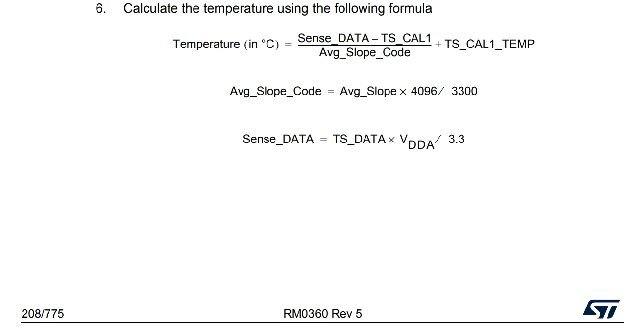

I'm using STM32G070RBTx, and I use this formula from document RM0360 to compute temeperature:
From page 56 of document https://www.st.com/resource/en/datasheet/stm32g070cb.pdf, I'm using:
Avg_Slope = 2.5 and V30 = 0.76.
The temperature converted value I obtain at ambient temperature appears reasonable ( 21 °C approx. )  but when the temperature increases the  raw value I get from ADC also increases but using formula above gives a decreasing temperature value and this is wrong.
Please help.
TDKBest answer
Mar 11, 2024 12:45 PM UTC
Perhaps you are using an older version of the RM. Here it what the current version says:
This is the same as your formula except the sign on V30 and V_SENSE has changed.

TDKBest answer

Thanks TDK for reply, a couple of questions:
1) is VDDA in the formula the voltage power supply I use to power my board, that is 3.3 V, or is the voltage power supply used during factory calibration that is 3.0 V ?
2) in the formula provided shouldn't be Sense_DATA = TS_DATA / VDDA * 3.3 ?
mƎALLEm
Mar 12, 2024 2:34 PM UTC
Your actual VDDA value.
Beppe101Author
Mar 12, 2024 3:56 PM UTC
Thanks for helping, the formula provided appears to be working fine.
