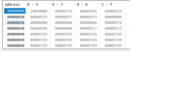

How could I guess when you don't answer my question about the contents of the flash at 0x0800003C and 0x0800803C ?

of course, sorry :(
@0x0800003C and @0x0800803C I have the address of the systick_handler (handler incrementing a static variable on each IT at 1ms).

This values seem to be good.
when I look the flash memory address corresponding to the 0x0800803C content, it correspond to the systick_handler !
The problem isn't there.
The problem is that there isn't IT event raised !

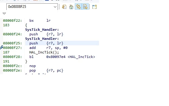

@0x0800803C contains 0x08008F25...
and this address location correspond to the systick_handler...
ABITT.1
ABITT.1Author
June 24, 2020

What value does the SCB->VTOR register contain?

Thank you for your question.
Finally, it's this register which have a bad value.
after modify it with the 0x08008000 value, it works fine :)
