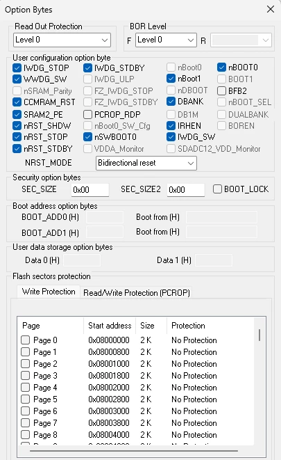

These are the settings when i read from the stlink utility
Below are the option byte settings
Anything wrong with them please advise.
Ozone
Principal
June 18, 2026
I don’t use CubeIDE, but the settings look ok to me.

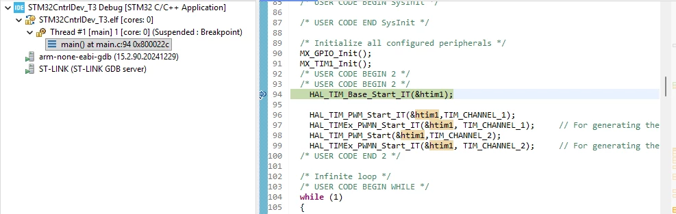

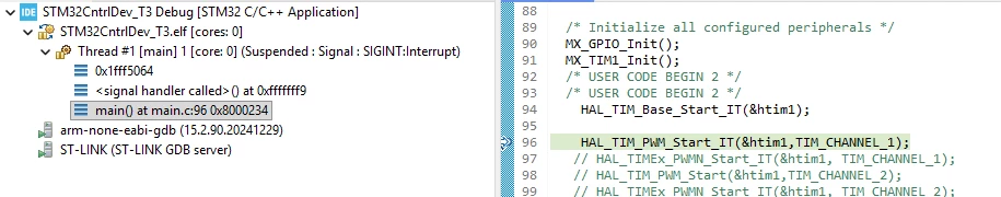

when i step over the Timer
HAL_TIM_Base_Start_IT(&htim1); it resets and also systick handler does not happen. I verified the systick handler without the timer interrupt as well.

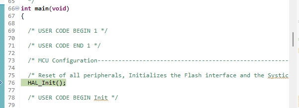

Have you stepped into the HAL_Init() code, to see if Systick is initialized ?
Or stop before entering the “while (1)” loop in main, and check in the peripheral view if the Systick registers are initialized.
If I’m not mistaken, you can set another timer than Systick to drive the Cube/HAL timings.
STuser2Author
Senior III
June 18, 2026
I will check it now and post my observations.

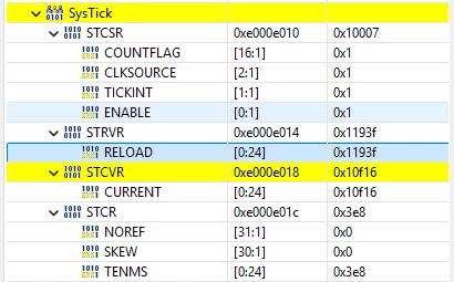

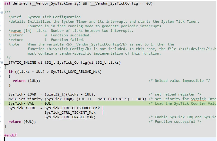

This code is commented but still executing. The file is core_cm4.h.
Ozone
Principal
June 18, 2026
What you see in the CubeIDE is the interpretation of the editor’s parser, but not of the compiler.
I’m pretty sure you could set a breakpoint there, and it will work.
Those parsers usually do not see #defines that don’t come from include files but from makefiles or other meta-files (like__Vendor_SysTickConfig in this case).
At least the register values suggest it is executed, as all required flags are set, and the reload value seems plausible.

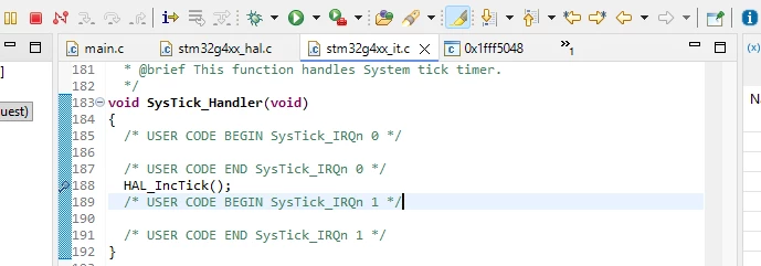

You can try to locate the actual interrupt handler (somewhere in the Cube code), and set a breakpoint there and see if it fires.
And check if respective HAL delay routines get called.

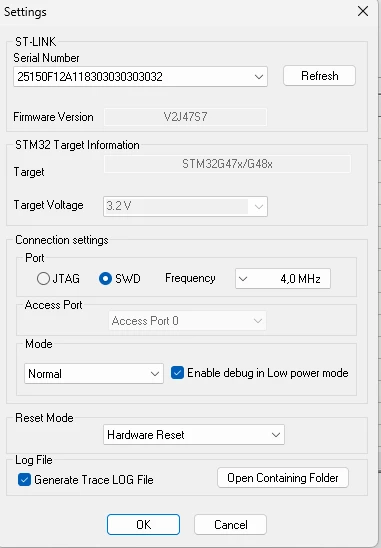

The STLink Utility has long been obsolete - it was probably obsolete before the G0 was introduced.
Have you tried using STM32CubeProgrammer ?

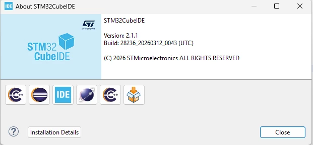

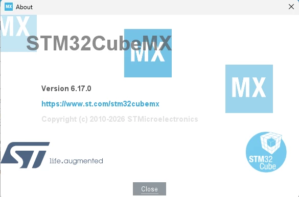

You haven’t said what versions of CubeMX or CubeIDE you’re using.
STuser2Author
Senior III
June 18, 2026
The CubeMx version is
I like using STLink Utility may be i will switch over to ST Cube Programmer.

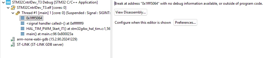

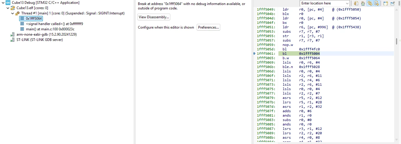

Once the code is executed after line 96 the control is lost and does not execute the next instructions.
Andrew Neil
June 18, 2026
It must be executing instructions somewhere - a microcontroller doesn’t just stop.
If you let it run in the debugger, then halt it - where is it?
My guess would be that it’s in the Default Handler - which is an infinite loop - because you haven’t provided a handler for the timer interrupt.
