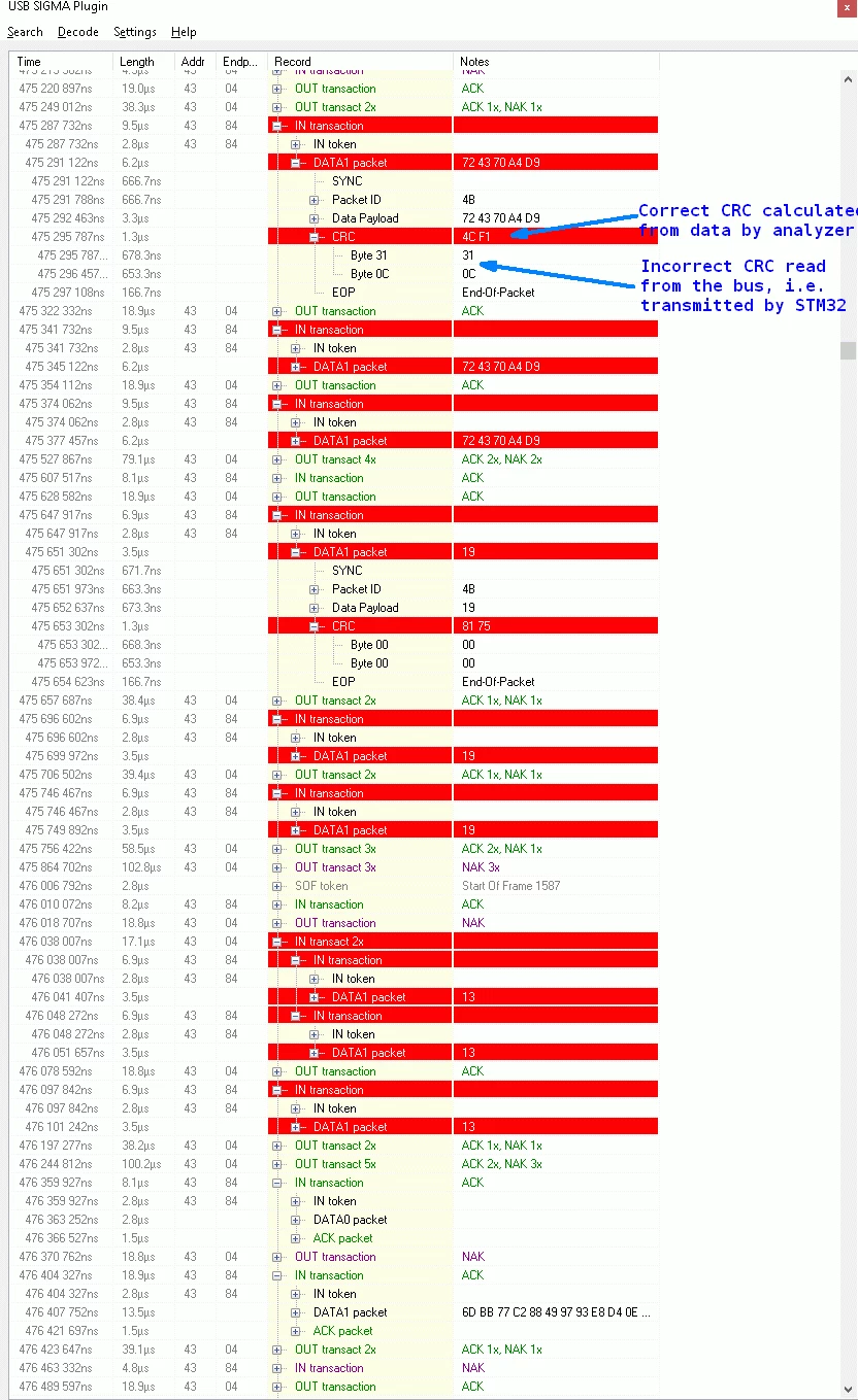

In dervice mode, an In endpoint was configured to transmit one 16-byte-long packet, and then 16 bytes (i.e. 4 words, 72 43 70 A4 D9 99 55 2E 19 7F 32 37 13 EB B6 7E) were being written to the endpoint's Tx FIFO, in "main" (and instrumentation and logging confirmed they were indeed written to the FIFO all, as 4 words), when the USB interrupt kicked in and it read from the Rx FIFO. The result on the bus was:
So what we see here? The USB core decided to transmit the first 5 bytes, 72 43 70 A4 D9, and appended the CRC calculated from the first 4 bytes of these 5. Naturally, host refused to ACK this. Core retried 2 more times, and the apparently gave up, inserting a zero-length DATA0 packet at 475 607 517ns (not expanded on that view, sorry). Then the USB core skipped 3 bytes (I'd say, in the first case it took 2 words, but used only one byte of the second word) and then transmitted one byte, with the CRC of 0 bytes (i.e. 0000). Rinse and repeat. Then core threw transfer complete interrupt and everything proceeded as usually.
I've seen similar patterns with the data packet containing 13 bytes, with CRC of the first 12 of them.
Preventing the USB interrupt to kick in solved the problem entirely; and also helped selectively disabling the particular interrupt resulting in reading from Rx FIFO (and not running any other In endpoint i.e. writing to some other Tx FIFO).
The "factory" firmware fills FIFOs only in the interrupt so it won't be hit by this. This is nice, but IMO working more by accident than by deliberate design, given the documentation doesn't appear to talk about conflicting FIFO accesses. In fact, there's nothing which would indicate, that the individual endpoints are not completely independent from each other.
Can you expand a bit on this? I am debugging an issue where we are putting 6 bytes into TXFIFO and I see on the wire 5 bytes with a bad CRC.
waclawek.jan
January 22, 2025
I was writing TxFIFO in "main" (i.e. low interrupt priority context) and reading RxFIFO in the USB interrupt context.
What happened was, that while having written TxFIFO partially from "main", the USB interrupt kicked in with Rx data available and I read them out, and this resulted in the faulty pattern (CRC) when subsequently transmitting those partially written data from TxFIFO onto the bus.
My solution was to disable interrupts (causing RxFIFO being read) while writing TxFIFO.
Another possible solution (which may be the one used by Cube/HAL, I don't know, I don't use Cube/HAL) is to access all FIFOs only within the USB interrupt context; in that way each individual FIFO is always written/read entirely, with no interruption from other FIFO accesses.
This issue may be the consequence of the Transmit data FIFO is corrupted when a write sequence to the FIFO is interrupted with accesses to certain OTG_FS registers erratum, which appeared in the 'F407 errata on 21-Feb-2023 (note date of my original post above), so slightly different albeit related reason, nonetheless the corollary is the same.
Note, that what I wrote above pertains to the OTG in 'F4xx (I used both 'F407/427 and 'F446 and I don't remember which one was the one which threw me). The versions of OTG in individual STM32 models do differ in version, thus in details of their behaviour too.

Thanks for the reply. I am using F723. I am writing to the tx fifo in main and believe the SOF interrupt may be the culprit. I am writing two 32 bit words with 6 bytes of data and two bytes of padding. I am seeing 5 bytes and a bad CRC. Sounds very much the same issue. As soon as I wrapped the two FIFO word writes in __disable_irq() and __enable_irq() the problem disappeared.
waclawek.jan
January 22, 2025
SOF sounds to me like an unprobable candidate, but of course it depends on details.
Do you access any of the endpoint registers in the SOF interrupt?
You can try, instead of global interrupt disable/enable, to selectively disable only the SOF interrupt in GINTMSK (and perhaps reading it back just to be sure it's disabled before accessing FIFO) during the FIFO writes; if the problem is removed solely by this step, then it's indeed likely to be SOF-related.
