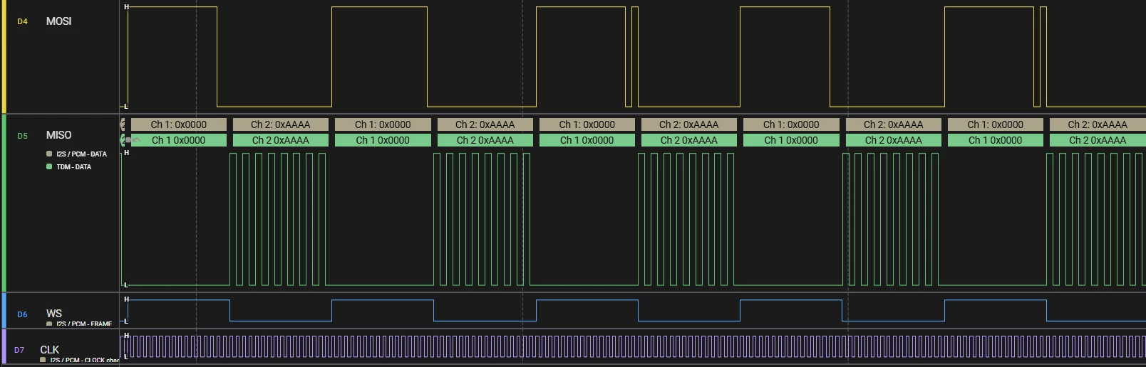

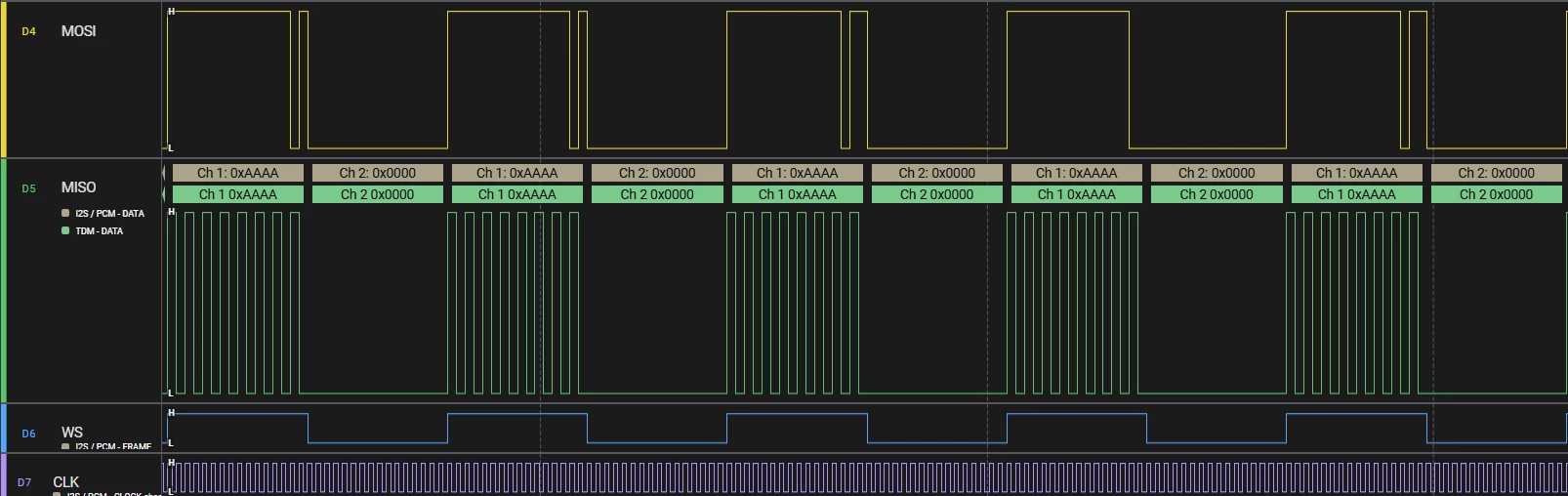

I have a STM32U585. I’m trying to use SAI to transmit and receive I2S audio as a slave. The I2S master is an external codec that’s configured for stereo 16bit 16kHz audio. Mic/input from codec->MCU and speaker/output from MCU->codec. The first stereo sample received on the codec is routed to the left speaker and second to the right.
This works as expected for the mic. For the speakers, sometimes even samples will play on the right side and odd on the left. I’ve loaded the DMA buffer with dummy values 0xAAAA and 0x0000 to demonstrate. MISO is the signal of interest here. I’d like 0xAAAA to be on Ch 1 consistently.
Expected Samples
Unexpected Samples
This occurred about 50% of the time. It’s observable for the entire runtime and doesn’t correlate with how long the software has been running. I suspected a sync issue SAI/DMA so I implemented a quick hack to poll the GPIO to start the DMA transfer after the falling edge of WS to help sync. This improves reliability from 50% to 90%. I’ve included a simplified snippet of the code.

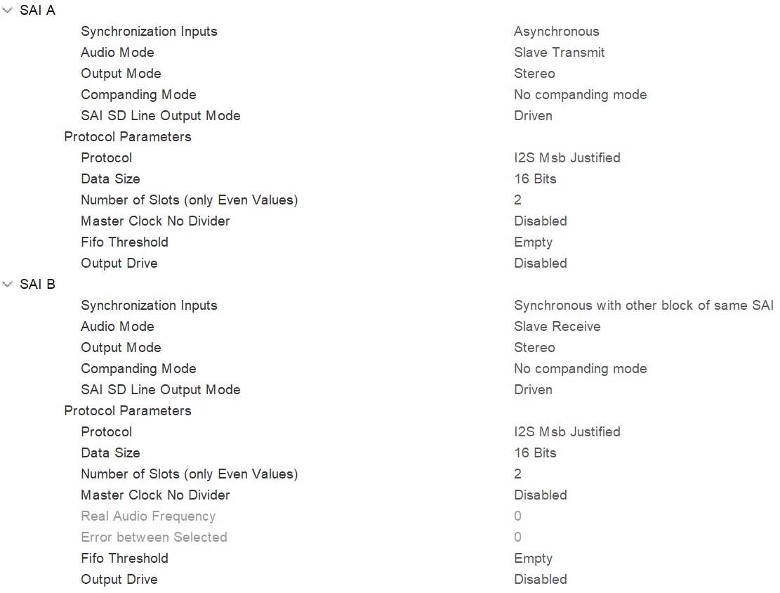

I am using SAI1 block A for async Tx and SAI1 block B for sync Rx both with DMA.

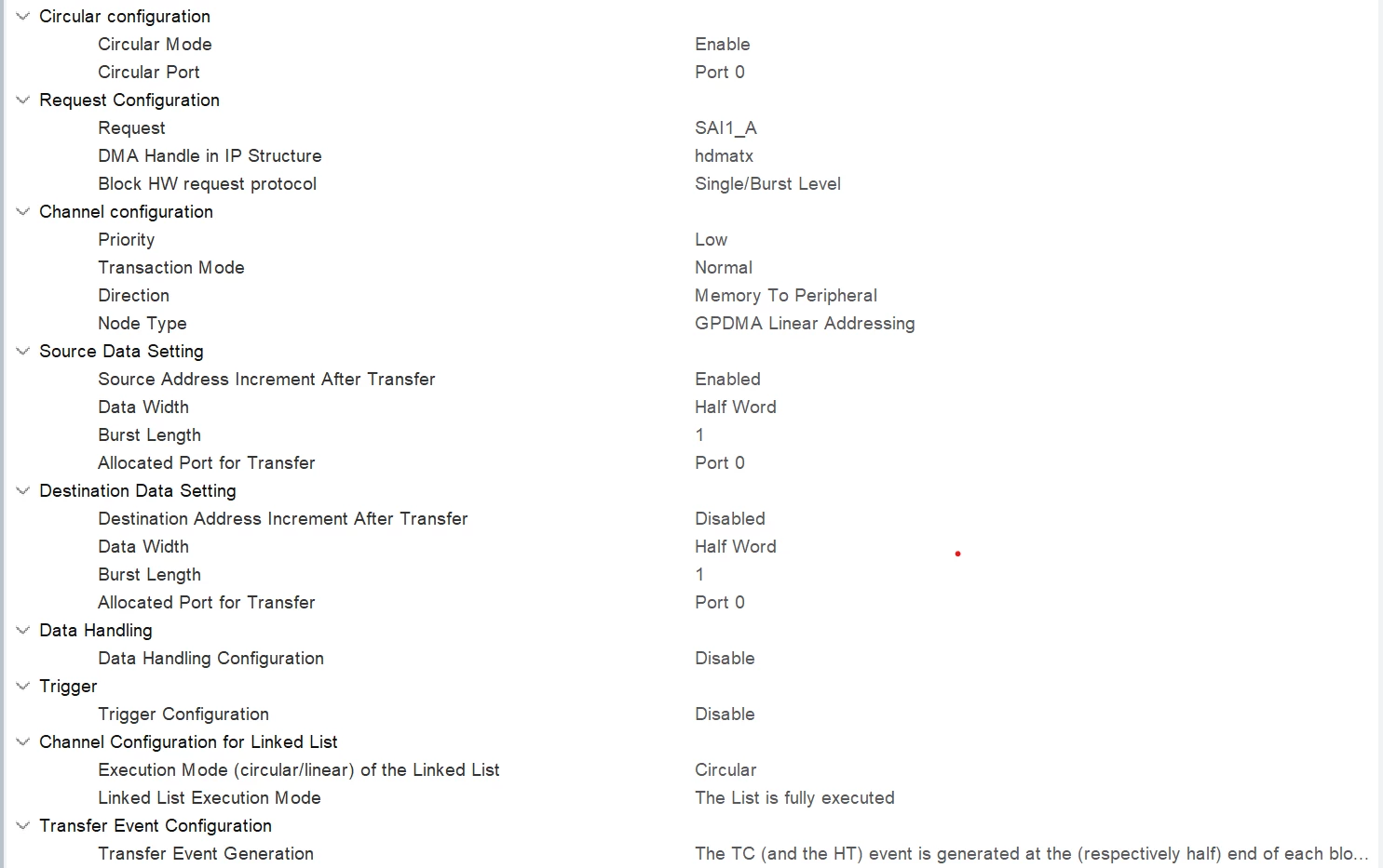

Your DMA is circular meaning the linked list (with probably one entry) does not terminate it keeps reloading the destination rings and  source rings. This is simplest to do using four DMA channels
I am only using two DMA channels because the stereo samples from left and right are interleaved. So instead of Rx L, Rx R, Tx L, Tx R it’s just Rx and Tx.
Also that all four rings are separate - no way they can overlap (that’s the advantage of 4 DMA channels doing the job). If you are using two DMA channels it can be done but the linked list and trigger event becomes more involved I think.
HAL SAI has HAL_SAI_TxHalfCpltCallback and HAL_SAI_TxCpltCallback to signal which side is ready. I had implemented these for Rx but not Tx. Sometimes my buffer would write part of one audio frame to one side of the buffer and part to the other side. If I fill the audio frame with 0x00, 0x01, 0x02…, the skipping is clear on the I2S analyzer. However, even with this fix, the samples still swap between channels on I2S.
So there was a trigger event bug as you predicted, along with another bug that is causing the original swapping issue.

If the FIFO threshold is set to EMPTY, the DMA may provide only one data word to the FIFO before the SAI starts transmitting. After transmission begins, the DMA refills the FIFO only when it becomes empty again.
In this situation, it is possible that at startup:
  • SAI transmits the first word already present in the FIFO,
  • but the DMA does not refill the FIFO quickly enough before the next slot is transmitted,
  • so the SAI may repeat the previous word or shift the channel alignment.
This could explain why the left/right samples are sometimes swapped, and why the issue seems to occur only at the start of the stream.
A useful test would be to increase the FIFO threshold, for example to HALF FULL. In that case, the SAI would wait until several data words are already present in the FIFO before starting transmission. This gives more margin at startup and may prevent the initial channel misalignment.
