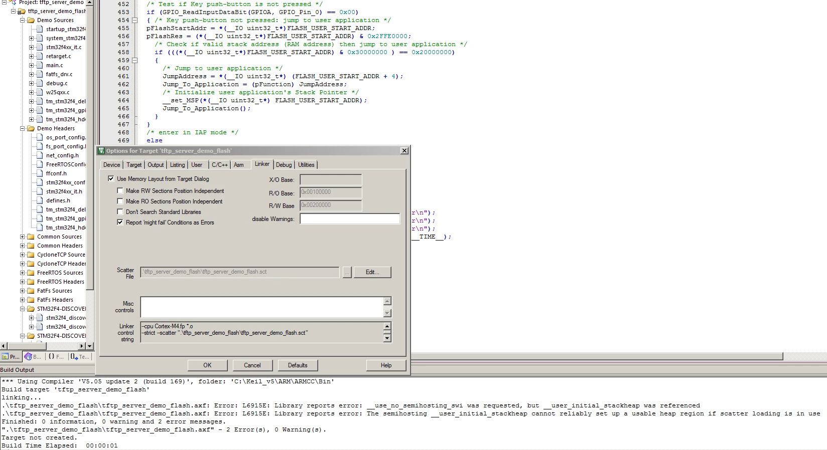

Ogulcan Ariyurek
May 7, 2019
If I check the "Use Memory Layout from Target Dialog", I get the attached error.
