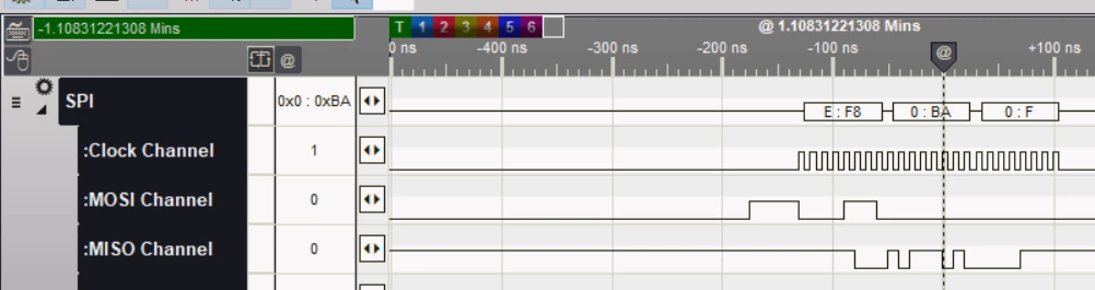

Good day,
I recently made a post about getting my SPI to a certain speed. Ive managed to get the core down but found out that HAL is way too slow for what I need. I thus switched to low-level drivers. Now using LL instead of hal, Im trying to do a simple transmit receive to my 24 bit SPI. While HAL used to work, I'm doing something wrong. me and my collegue can't put our fniger on it. Anyone here think they might be able to help figure it out? Code is added below. many thanks in advance!
Board is the STM32 H755ZIQ.
Also before this comes up, yes I will likely have to do this through DMA eventually. This will have to do for now though.

What problem(s) are you having with your LL code?
IgneousAuthor
Mar 27, 2025 8:44 AM UTC
The code seems to get stuck in the transmitreceive method Ive written. For some reason it appears that, once it gets to the RX section of this code, it hangs on the RX flags and never passes them.
IgneousAuthor
Mar 27, 2025 1:01 PM UTC
Update:
I've changed some of the code. I now have a responce in my logic analyser that I can see. Problem is that it's not being read as rxdata for some reason and still getting stuck in the loop on [while (!LL_SPI_IsActiveFlag_EOT(SPI1));]
Logic analyser:
Current method:

IgneousAuthor
Apr 1, 2025 1:51 PM UTC
While I have not yet found the solution, I have found that the speed might just be enough this way. However I might instead just start directly writing to the register to make it as optimal as possible. This week im occupied with other work but I will update when/if I have more info on how this is going.

IgneousAuthor
Apr 1, 2025 2:57 PM UTC
