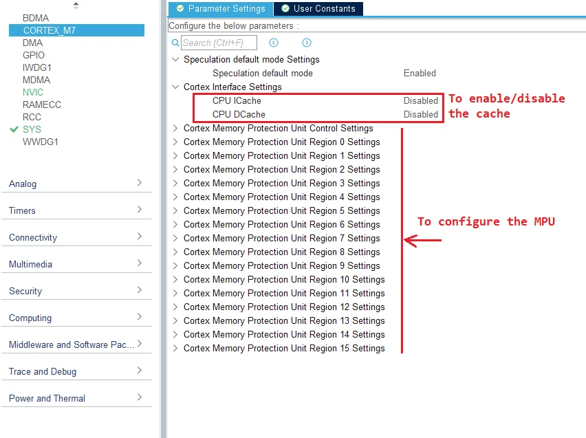

I am running a NAND flash with STM32H7 microcontroller using FMC interface. I have referred to Using the high-density STM32F30xxD/E FMC peripheral to drive external memories datasheet for the programming purpose.
While communicating with the device, I observed that whenever I read the device for the first time I get the desired data. But when I try to access it once again using different command the data section doesn't update. I read the old read data. For example,
If I send the command to read the id for the first time then the ID is properly read. But then when I send the command to read the status register then the old data doesn't get updated.
I even tried to reset the device before each command but the device read register doesn't update. Can you help me with this? What could be the problem?

Most probably it's due to the cache. What if you disable it? or just configure the MPU on that region: Strongly Ordered/Or Device?

Sorry, I didn't get you exactly. Which parameter are you referring to? Can you please specify with reference to CubeIDE?

In CubeMx. All is in Cortex_M7 menu:
