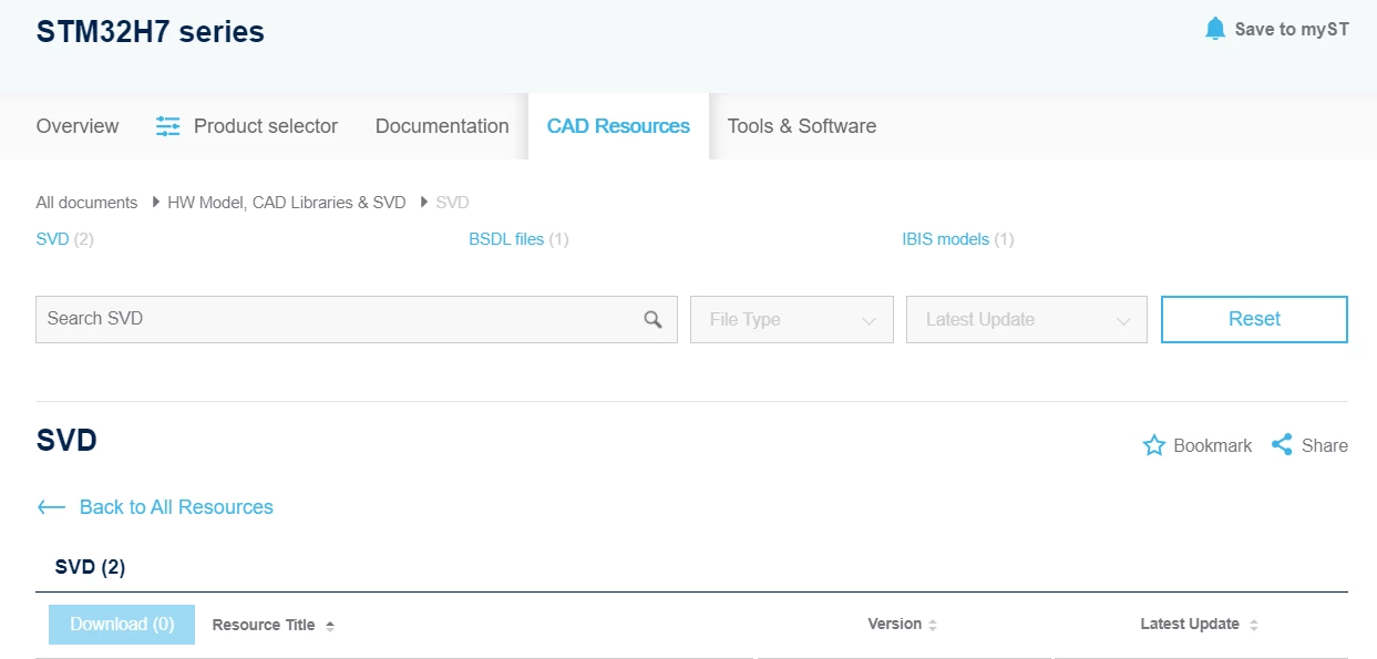

You can find latest updates of SVD files on st.com under STM32xx series > CAD Resources > SVD.
for example, for STM32H7 series, you find the package under https://www.st.com/en/microcontrollers-microprocessors/stm32h7-series.html#cad-resources:
These SVD files should be aligned with RM, but if you still note some discrepancies, please report them here in the community in separate threads.
