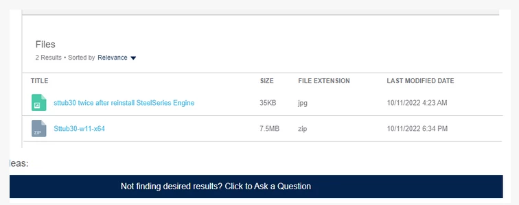

I'm a developer and need a working version of the Sttub30 .sys. Deletion is no solutio be cause we need to use it.
All references to a Sttub30-w11-x64 from 2015 with newer version that is compatible with core isolation.
But everything was deleted, because it was missused for MSI bluescreens.
The new DFU tool is No solution, because the driver device ID has changed and it needs complete other tools and driver and protocols.
We can not update all  devices for the new tool.
PLEASE. This one screenshot is the only hint that is left of the driver in the hole internet:
