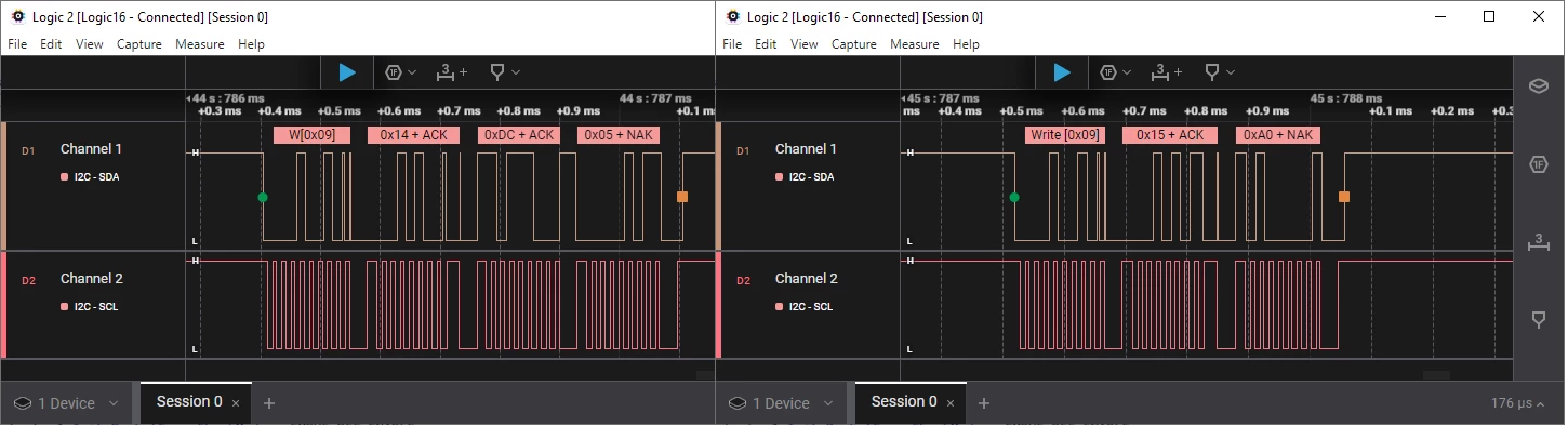

Thank you for your response. I can confirm that the address is retransmitted for the second command.
For comparison, this capture shows the two messages when I use the ST SMBUS stack code with own address set to 0x12 (7-bit address 0x09). This is working fine.

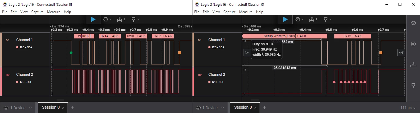

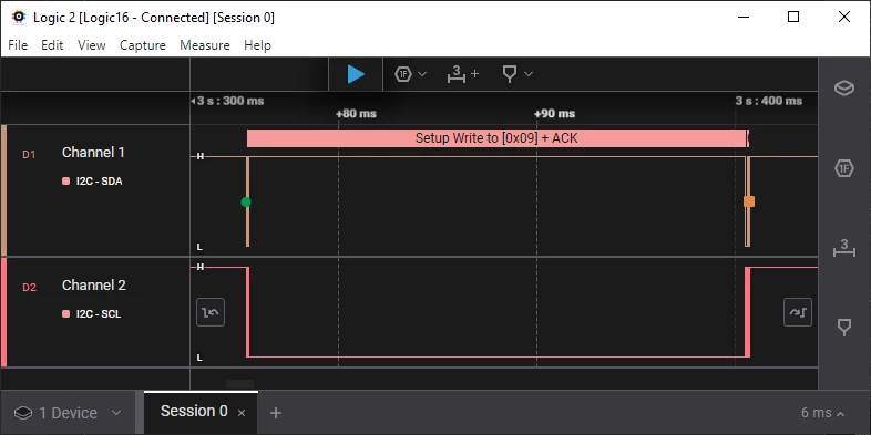

This image shows the two messages when I use my own code to intercept the ADDR interrupt callback and so on as described. The first one appear to do the right thing. The second (and subsequent) message fails. The address appears on the bus but ADDR interrupt callback is not called. It seems that the interrupt does not occur at all. So the clock is held low for 25ms (the configured timeout), and then the next byte appears (presumably when the clock is released), but is NAKed.
I'm pretty sure that the ADDRI flag is set to allow the address interrupt, but suspect there is some other settings which I have not got quite right. The initial set up is fine, but perhaps there is a side-effect of receiving a message which I have not dealt with correctly.

I see that the address is acknowledged by the slave. Check if the address match flag is set in the SR register. If yes, insert a breakpoint in the SMBUS IRQ Handler to observe the behavior during the address interrupt event.
