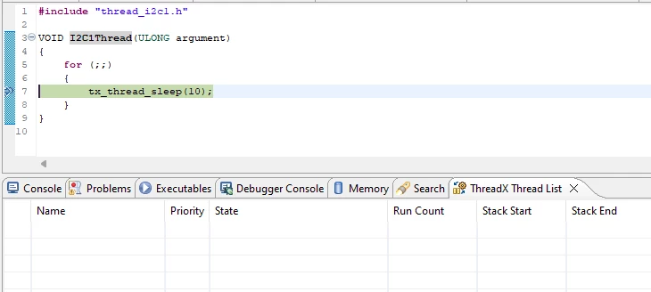

And when I debug the application, as soon as the second thread starts, I can no longer see the other thread running.

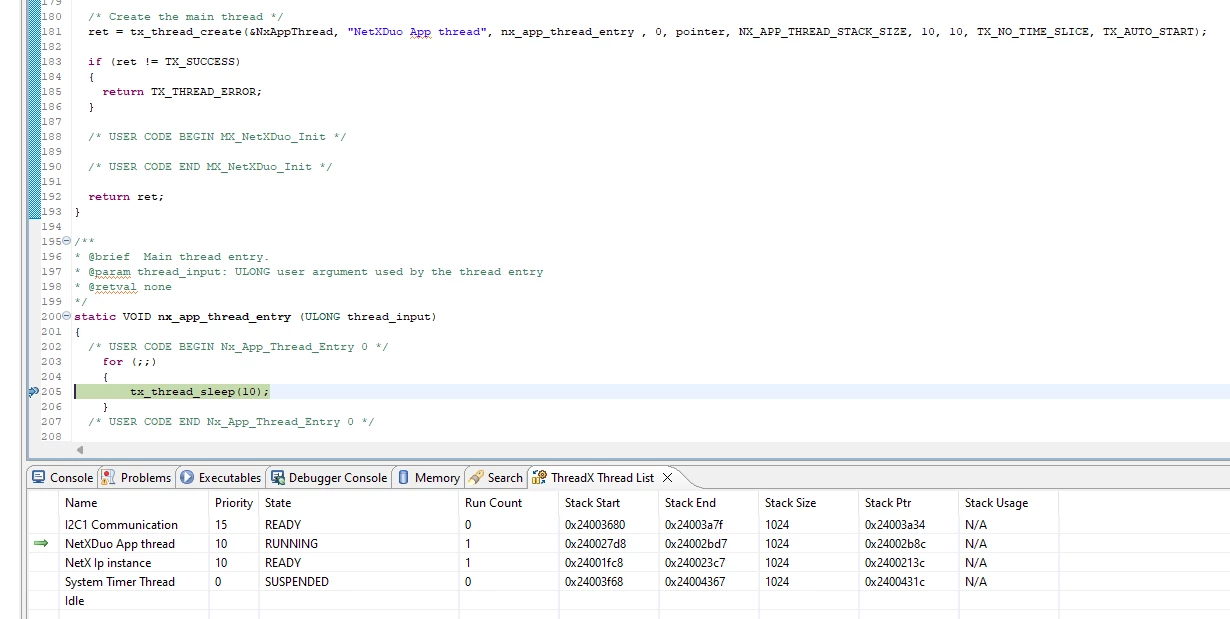

Here's an screenshot when I enter the first thread: (all good, I2C1 and NexDuo thread are there)
Once I enter the breakpoint on the second thread (I2C1) everything disappears (and I will never enter into the first thread ever again)
I left the threads empty on purpose (I removed as much code as I could to pinpoint the issue)
But right now, I'm a bit puzzled...could it be a configuration issue?

It looks like I didn't allocate enough memory to the ThreadX memory pool.
I'm slowly putting back features in the threads, but it looks like it was the issue. Sorry for panicking too soon :)
