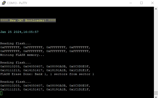

Hi there!
Experimenting FLASH reading/writing I done a fanny test that is giving an unexpected (to me) result.
Basically:
1) I defined  2 32 bytes buffers (aRbuff for read, and aWbuff for write)
u32t aWbuff[8U] = {
		0x00010203, 0x04050607, 0x08090A0B, 0x0C0D0E0F,
		0x10111213, 0x14151617, 0x18191A1B, 0x1C1D1E1F
volatile u32t aRbuff[8U] = {0};
 2) I implemented my read, write and erase function and i integrated them into the main infinite loop
	if(bIsErase == TRUE)
		EraseFLASHsectors(uiADRtest, uiSect2Erase);
		bIsErase = FALSE;
	if(bIsWrite == TRUE)
		printf("Writing FLASH memory...\r\n");
		WriteFLASHdata(uiADRtest, aWbuff, 32U);
		bIsWrite = FALSE;
	if(bIsRead == TRUE)
		printf("\r\n");
		printf("Reading flash...\r\n");
		ReadFLASHdata(uiADRtest, aRbuff, 8U);
		printf("0x%08X, 0x%08X, 0x%08X, 0x%08X,\r\n", aRbuff[0], aRbuff[1], aRbuff[2], aRbuff[3]);
		printf("0x%08X, 0x%08X, 0x%08X, 0x%08X,\r\n", aRbuff[4], aRbuff[5], aRbuff[6], aRbuff[7]);
		bIsRead = FALSE;

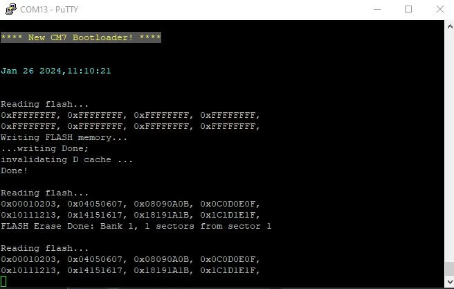

Writing a FLASH word and reading it back works fine, but if I perform a sector erase and then I read newly the FLASH location I get the pattern I write previously... It seems the erase hasn't done!
But if i reset the MCU and connect again, reading the location gives al 0xFFFFFFFF, so erase has been performed.
Since Im working on the M7 core of a stmH755ZI, I'm in doubt that is a problem of cache coherence, and I tryed to address it in software without luck.
Since sutch topic is just a little cryptic to me, anyone has an idea?

AScha.3
Jan 25, 2024 5:42 PM UTC
Just as a test : disable (or not enable) caches , at least D-cache. Then try again.
Tesla DeLorean
Guru
Jan 25, 2024 5:47 PM UTC
Why wouldn't it be the cache? Either the architected one or the ST ART unit if present?
Your code doesn't show you doing anything to address that.
Should use the "DCache Invalidate by Address" after the FLASH write has completed.
Jan 25, 2024 7:07 PM UTC
+1 to potential cache issues.
Could also be that you're simply not erasing the memory you think you're erasing. Not enough information in your post to determine that.
iTTy
iTTyAuthor
Jan 26, 2024 9:12 AM UTC
Hi everyone!
@AScha.3 :I done the test you suggested. Disabling (only) the data cache fix the problem, while disabling the instruction cache doesn't affect the reading behaviour.
@Tesla DeLorean : Actually i tried the cache management fix in another software branch (I posted only the original version giving the issue). I'm not using the ART.
@TDK : FLASH operation is validated through readings after MCU reset and through the test suggested by @AScha.3 .
Anyway, I tried several tests invalidating and cleaning the D cache without success. I always "pointed" to the reading buffer aRbuf.

Edit:
I done the tests that @Tesla DeLorean suggested (i invalidate the cache on aRbuf after FLASH writes)
	SCB_InvalidateDCache_by_Addr((void*)aRbuff, 32);
	bIsErase = FALSE;
	printf("...writing Done;\r\ninvalidating D cache ...\r\n");
	printf("Done!\r\n");
	bIsWrite = FALSE;
if(bIsRead == TRUE)
	printf("\r\n");
	bIsRead = FALSE;
but the behaviour doesn't change.

Jan 26, 2024 11:45 AM UTC
Sorry for insisting, but I have to understand!
Following the explanation of @AScha.3 , I clean the D-cache after sectors erase (using SCB_CleanDCache_by_Addr) then I invalidated the chache after FLASH reading (using SCB_InvalidateDCache_by_Addr). In both cases I "pointed" to the FLASH address, not at the reading buffer; because is the FLASH content that is changed by erasing.
It seems work!
Doing some tests more, trying some cleaning/invalidation strategies, I obtained that the only working solution is to invalidate the cache after readings or after erase. Cleaning the cache doesn't work!
What the difference between SCB_CleanDCache_by_Addr and SCB_InvalidateDCache_by_Addr?
