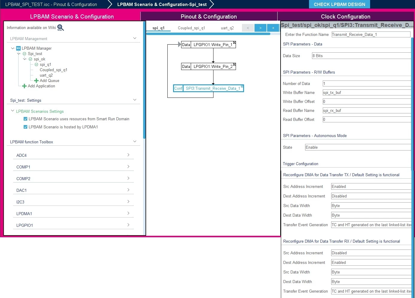

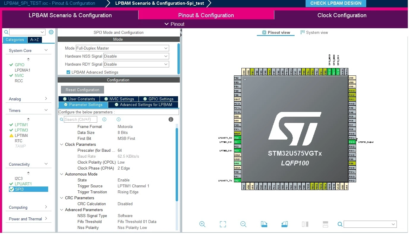

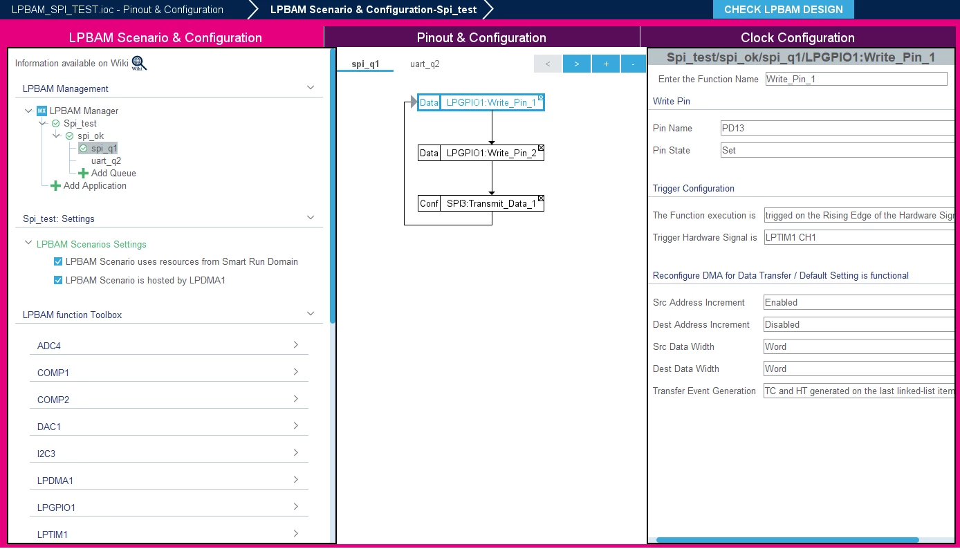

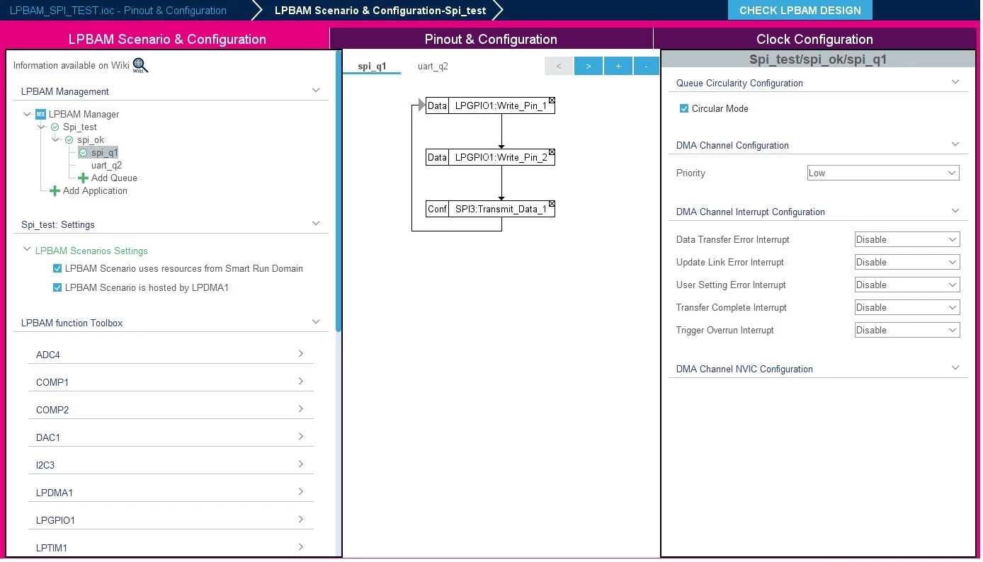

I want to read data from an SPI slave using SPI3 while the MCU is in STOP2 mode.
The communication protocol requires me to transmit a command before receiving the response.
I configured LPBAM according to the following YouTube tutorial, and my CubeMX/LPBAM configuration is shown in the attached screenshots.
My observations are:
  • If I use only the “Transmit Data” node, everything works correctly.
  • If I add a “Receive Data” node after the transmit node, the SPI transaction stops when it reaches the receive node. However, the “LPTIM1_CH1” output continues to generate trigger signals.
  • If I replace them with a single “Transmit Receive Data” node, neither SPI nor LPTIM1_CH1 works.
Could you please explain what might be causing this behavior? Is there any additional configuration required to use the “Transmit Receive Data” node in LPBAM with SPI3 in STOP2 mode?
