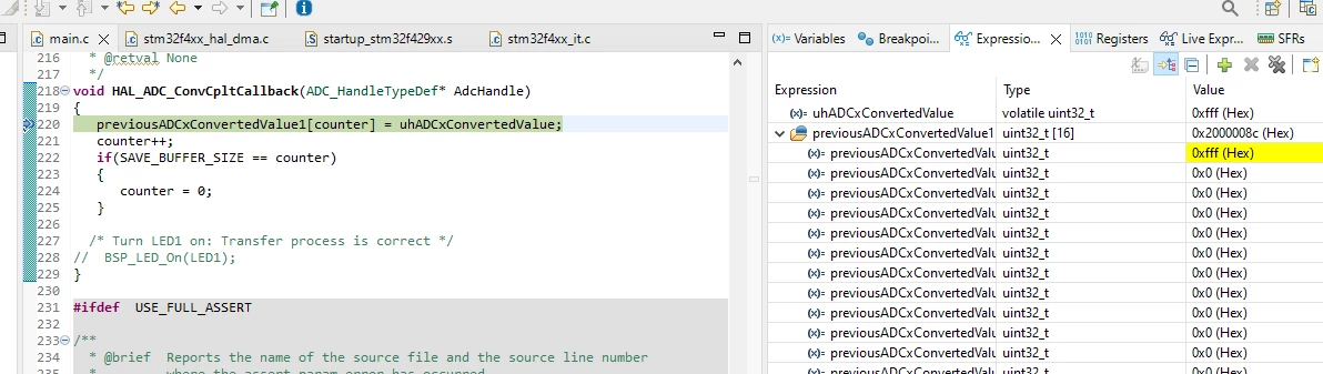

My HAL ADC conversion complete callback function now looks like:
void HAL_ADC_ConvCpltCallback(ADC_HandleTypeDef* AdcHandle)
 previousADCxConvertedValue1[counter] = uhADCxConvertedValue;
 counter++;
 if(SAVE_BUFFER_SIZE == counter)
 counter = 0;
 /* Turn LED1 on: Transfer process is correct */
 BSP_LED_On(LED1);
With previousADCxConvertedValue1, a global variable array of size: SAVE_BUFFER_SIZE

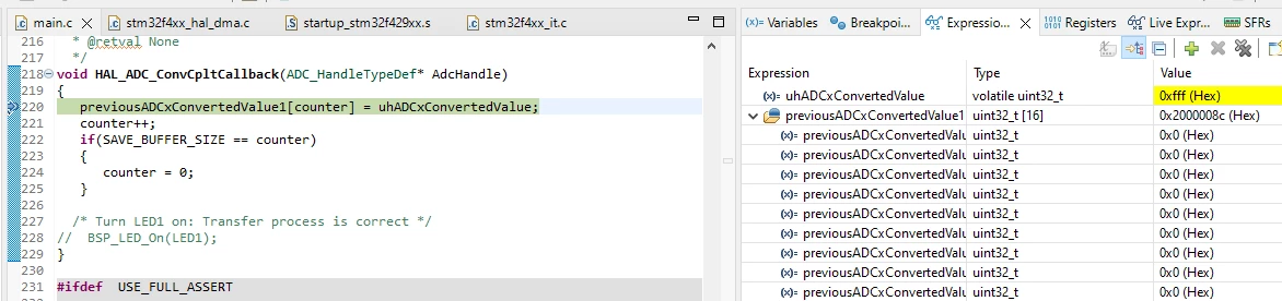

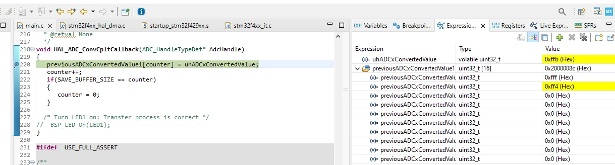

And again, I am indeed a suspicious guy, I want to be sure that each converted value are saved in this array, not that some values are missing.
I will be surely discarded for what I did, but: I added a breakpoint on BSP_LED_On() to check that each time a conversion + DMA transfer is done, value is saved.
But it does not...
There values are totally different... maybe like there are a couple of other ADC conversion + DMA transfer which do not trigger this callback. I made 5 iteration (5 times resumed program after breakpoint hit) and got the following evolution of my array:
Here, we may confirm that values in array do look like value coming out from the ADC (it is linked to +3V3 with a 10k resistor) BUT they are not equal to value transferred with DMA.
Anyway, I am pretty confident, there is something I missed or making wrong. But I am questionning this example, because I met this problem first when I adaptated it with to scan mode, with 3 channels on ADC1 (channels 10, 11 and 13).
Willing to check what I wrote for code is right, I tried approximately the same, but I also got random value and not a clean sequential save of my converted values.
How may I do it the right way? How may I check that all my ADC values are cleanly saved somewhere after DMA transfer and I can add some processing on it?
