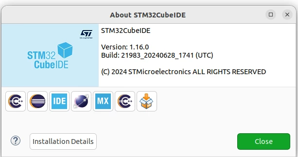

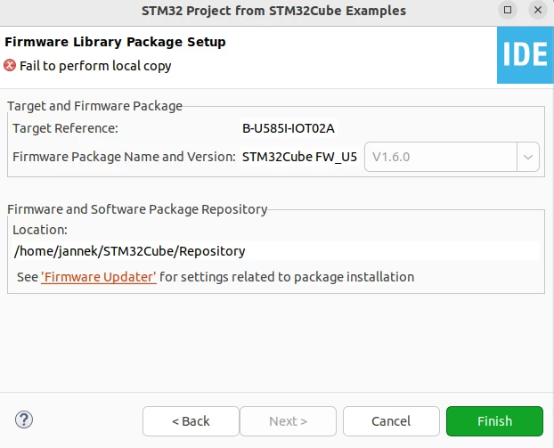

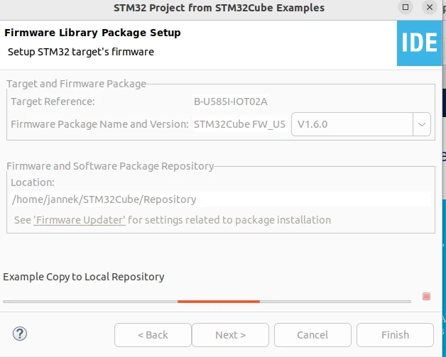

With latest STM32CubeIDE:
when I try to import a project for U585 with ThreadX and NetX Duo, I get local file copy failure.
Issue #1 - you need to add more details/logs, so that we can know WHICH file / package is causing the issues. It's a guessing game now.
Issue #2 - the importer downloads some file, which has a license I should read. If you click there to read it - browser just says the file is not available!
Issue #3 - the README.md file is missing.
Is it because I can't read the license file? I did accept the terms and conditions (god knows what they were).
But, how do I know what other files are missing? Is the project now usable or not?
I have plenty of disk space available.

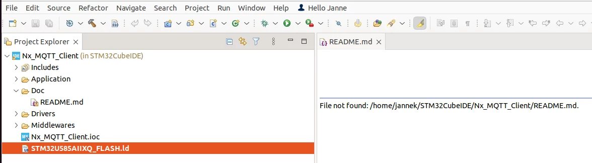

Good question is though why the heck is it looking up my ReText config file and using that? That's a BUG.
The same readme.md file is missing again.
File not found: /home/jannek/STM32CubeIDE/workspace_1.15.1/Nx_MQTT_Client/README.md.
The project does BUILD however, so could I assume all the source files made it? The README is however quite critical, because I believe it contains information how to enable dynamic memory allocations?

Aug 19, 2024 12:01 PM UTC
I removed ReText completely. That seems to have removed the error note, but the file still does not come along. You are doing something funny with the readme.md -file when copying.

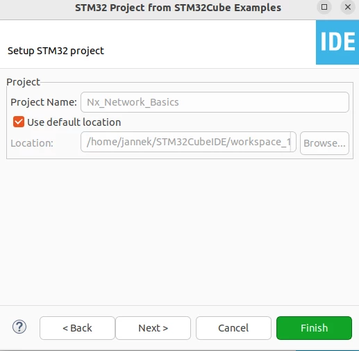

Aug 19, 2024 8:23 PM UTC

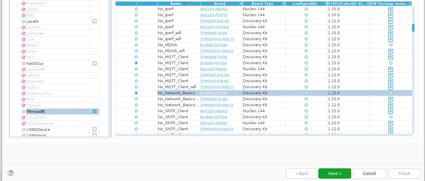

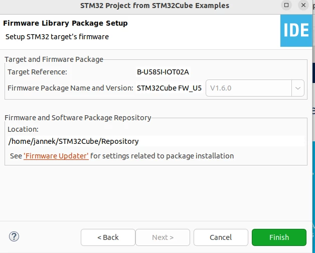

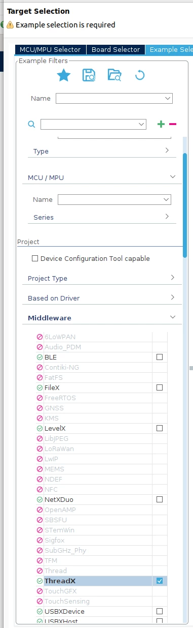

I am not agreeing with that assessment. I use this via the Information Center.
Import STM32Cube example.
Which then brings the STM Target selector.
I choose ThreadX.
Then I choose the example Nx Basic Network (or Nx_MQTT...) board, B-U585...
Press Next.
Press Next.
Press Finish.
It starts copying it over.
And README.md will be missing.
@Imen.D
I think this is the most basic use-case flow you have with this IDE?!

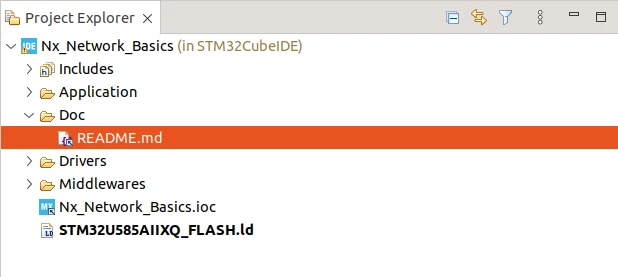

Aug 19, 2024 8:27 PM UTC
Now that I the deleted contents in the downloaded zip-file & folder and replaced the folder with the whole git repository (https://github.com/STMicroelectronics/STM32CubeU5) to the folder it had created and initialized it properly with the submodules as well the README.md does appear there. So, clearly the issue is with the fact that you are NOT INCLUDING the README.md to the zip file the IDE downloads.
Now that we know the Git repo contains the file and your .zip file does not - ask what is the process for creating the zip-file? Is there some kind of file black/whitelisting, which is now missing/hitting this file when it should not?
