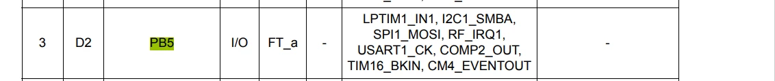

I am currently working on an embedded application using the LPTIM1 (Low Power Timer Mode) on an STM32WL55JC16 microcontroller. My goal is to count pulses from an external signal connected to the BP5 pin (assuming this is the correct pin for pulse input), and after counting 500 pulses, I want to trigger an interrupt.
yes it is.
there is a similar example in the provided CubeFW named LPTIM_PulseCounter: STM32CubeWL/Projects/NUCLEO-WL55JC/Examples/LPTIM/LPTIM_PulseCounter at main · STMicroelectronics/STM32CubeWL · GitHub
