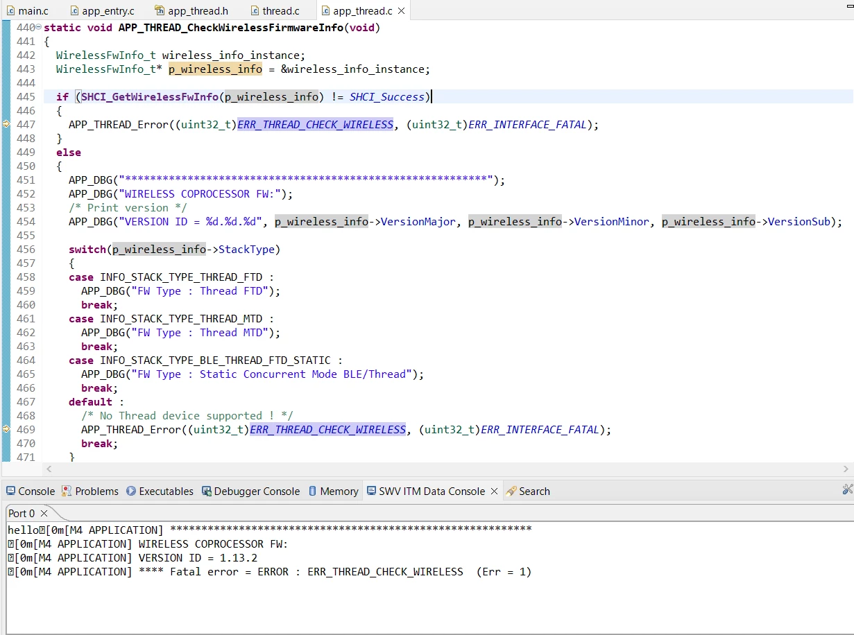

I'm working on a similar project, and I'm using the P-NUCLEO-W55 board. For the project, I'm using an unmodified example from STMicro called "Thread_FTD_Coap_Multicast." However, when I compile the project and run the program, the debugger shows an error "ERR_THREAD_CHECK_WIRELESS," which corresponds to /*No Thread device supported!*/ . Have you ever encountered this error? Do you know how to resolve it?
Thank you.

Hi @Cadixal ,
Sorry for late response. I think your problem occurs due to the stack. Can you check your stack? You can find the stack files and release note at "STM32Cube_FW_WB_V1.18.0\Projects\STM32WB_Copro_Wireless_Binaries\STM32WB5x".
