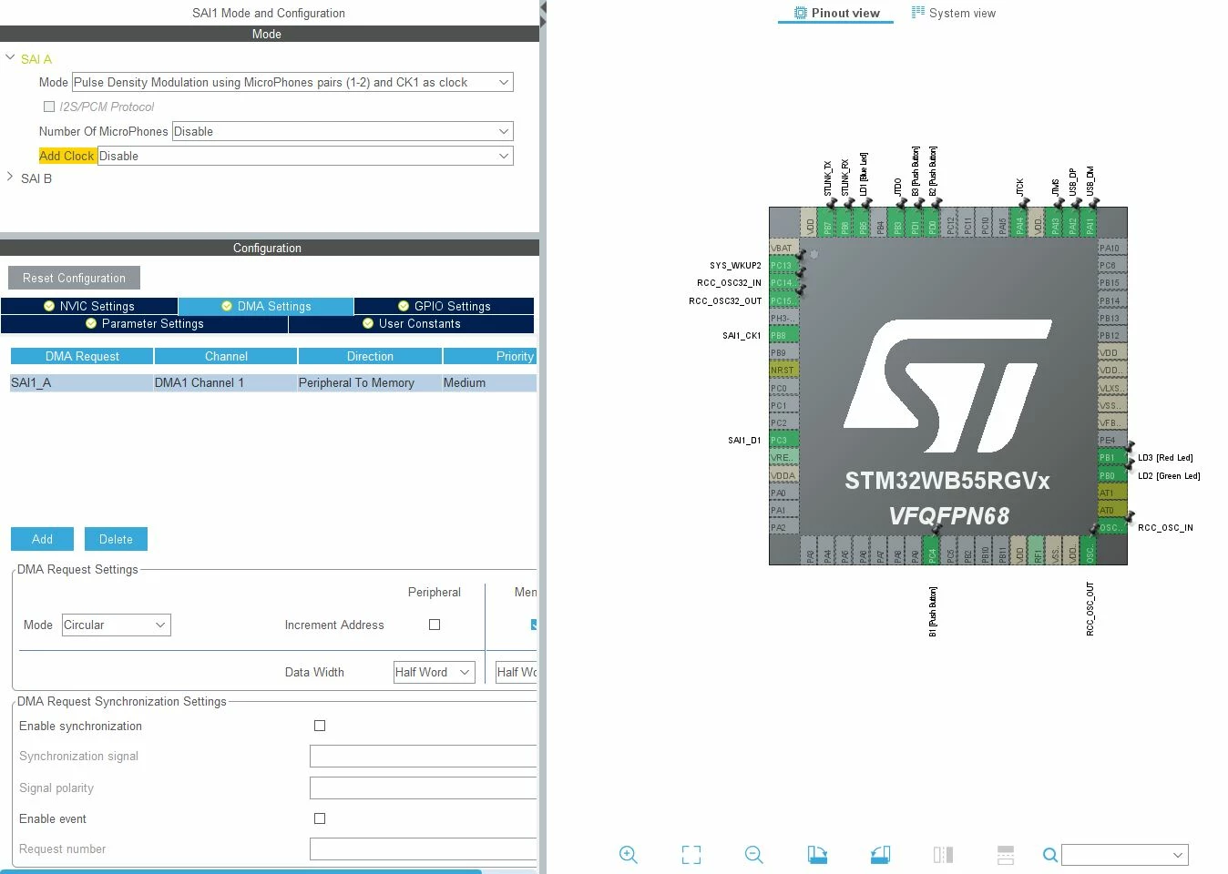

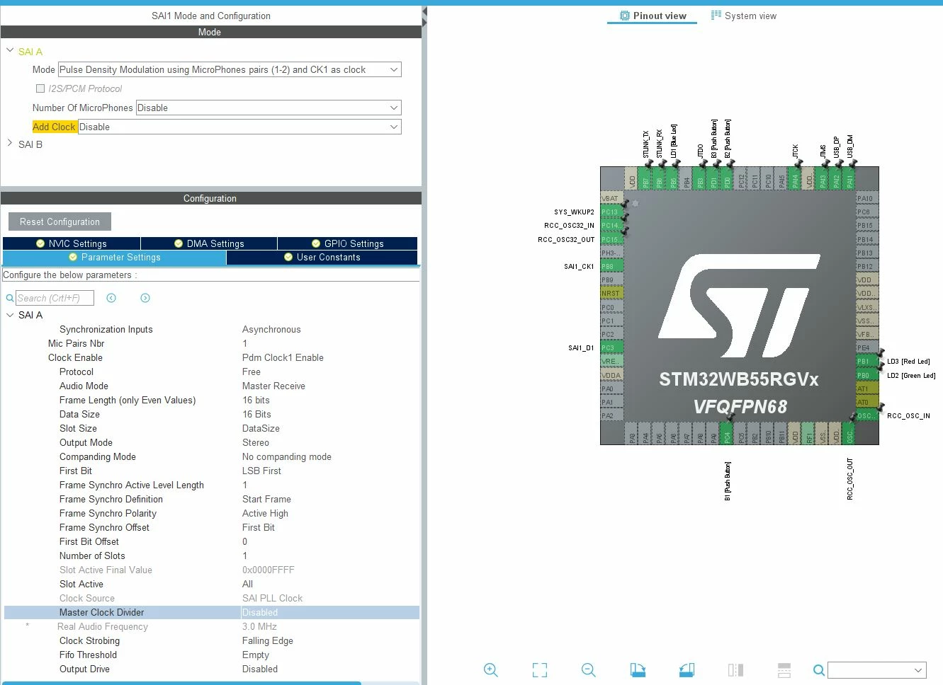

To generate code (setting of register) I used described example from section 4.3 of datasheet "Examples of configuration based on STM32CubeMX AN5027" and CubeMX.
and DMA:
Then I got two functions for the comprehensive PDM configuration:

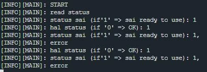

 uint8_t hal_status = HAL_SAI_Receive(&hsai_BlockA1, sound_in, 10, 1000);
 if (hal_status != HAL_OK)
 tr_info("hal status (if '0' => OK): %d", hal_status);
 tr_info("status sai (if'1' => sai ready to use): %d,", HAL_SAI_GetState(&hsai_BlockA1));
 Error_Handler();
 else
 tr_info("hal status OK");
 tr_info("data: %s", mbed_trace_array(hsai_BlockA1.pBuffPtr, 10));
 tr_info("sound in %s", mbed_trace_array(sound_in, sound_len));

but it recive error status HAL_ERROR
In mbed I don't change the clock setting so that may generate the error - I need connect clock to SAI periferia. Mbed doesn't give API to re-configure that - I don't want to do it on my own.
Or I made a configuration error.
someone can help me? I just need only read sound level not record or stream it anywhere.
