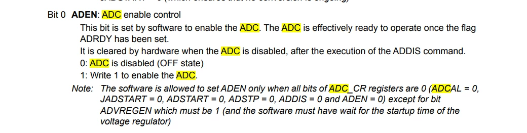

Hello @HTD
According to the reference manual (RM0456) the software is allowed to set ADEN only when all bits of ADC_CR registers are 0 (ADCAL = 0, JADSTART = 0, ADSTART = 0, ADSTP = 0, ADDIS = 0 and ADEN = 0) except for bit ADVREGEN which must be 1 (and the software must have wait for the startup time of the voltage regulator)
Please check if these conditions are ok on your setup before calling again HAL_ADC_Start_DMA.

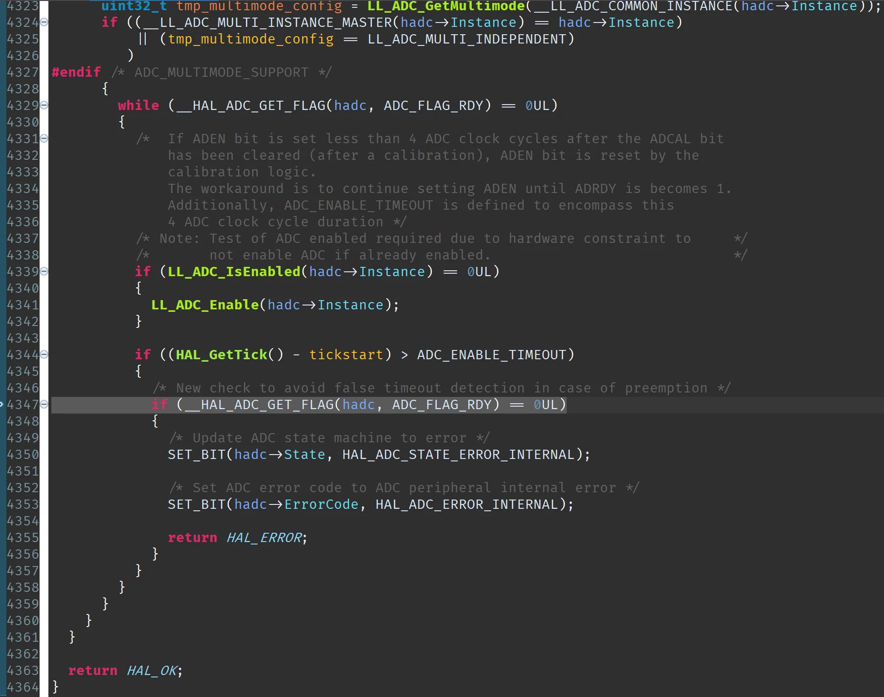

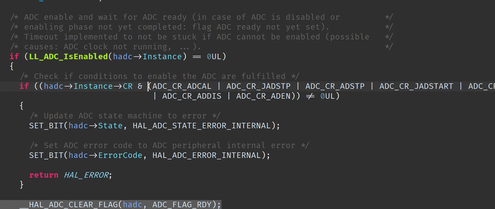

Ooopsie, I misread the register value. But it's not this:
As you see - the second pass (failed) passes through this check, so the CR state is valid.
It breaks later:
Line 4347 - just ADC_FLAG_RDY is not getting set in time.
Naturally, I checked what happens if I increase the timeout limit to 2 seconds, but obviously the ADC_FLAG_RDY doesn't get set at all, even one eternity later.
