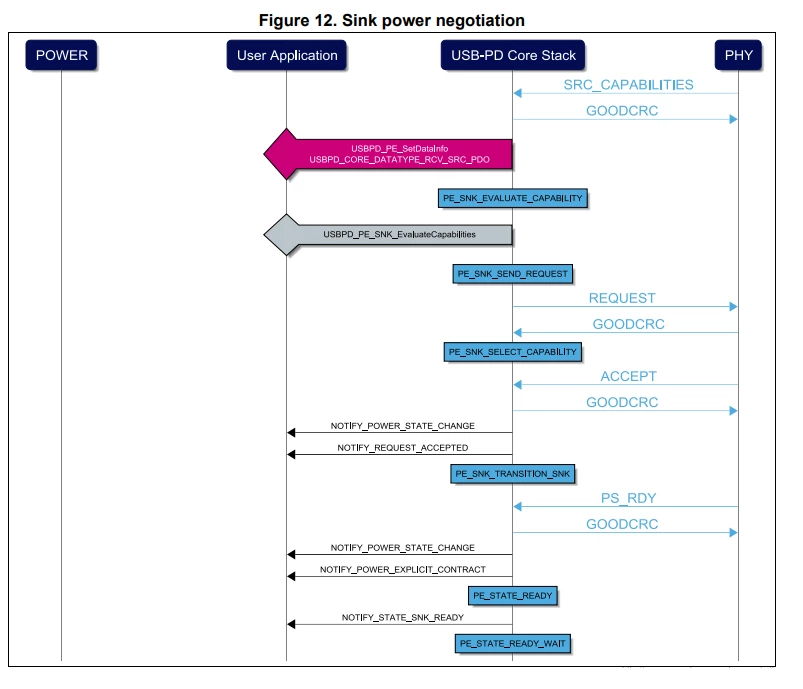

Here is what I have found so far, using this flow diagram as the expected sequence of events in a Sink Power negotiation:
-Device gets through initialization and reads the VBUS voltage correctly.
-When a USB-C cable is plugged in (USB-C to USB-C cable with USBPD capable power source) the program is able to enter the USBPD_DPM_SetDataInfo, but instead of entering with a USBPD_CORE_DataInfoType_TypeDef of USBPD_CORE_DATATYPE_RCV_SRC_PDO, it enters with USBPD_CORE_DATATYPE_RDO_POSITION and then with a subsequent call with USBPD_CORE_DATATYPE_RCV_REQ_PDO. It then repeats this a second time with nothing happening. This doesn't match the flow in the picture above.
-USBPD_DPM_SNK_EvaluateCapabilities is never called.

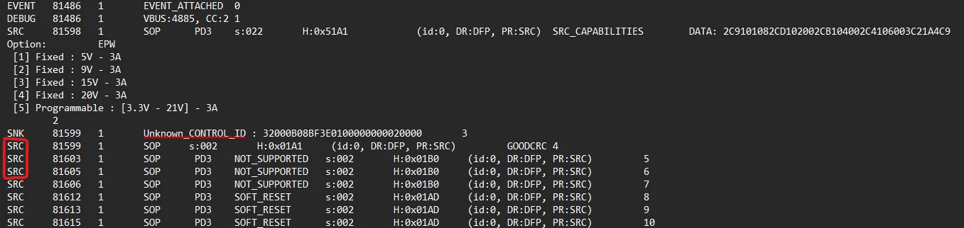

-I have used both the STM32 UCPD Monitor and a Cypress USB-PD monitor. All I see is that my device only ever sends zeroes back. I can see the USB-C power source sending the correct messages so I can confirm that the power source is working.

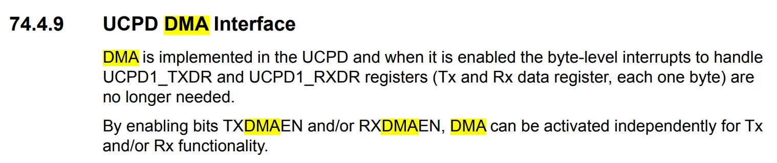

-I tried to look at the memory location where I would expect to see the full message received, but I only ever see zeroes (potentially a DMA issue?).

Also, noticed that the GPDMA IRQ Handlers (for USBPD TX and RX) have no code generated within them. Although in a lot of the other example projects there is no code generated in the handlers, so maybe this is intentional and not a bug.
Jan 27, 2025 3:01 PM UTC
Hi @cd3361
The GPDMA IRQ handlers are empty, and this is intentional, since the DMA transfer is being handled by HW in pooling mode.
When debugging, you can check transfer complete flags in GPDMA_C3CR are all set to zero which means they are not in interrupt mode.

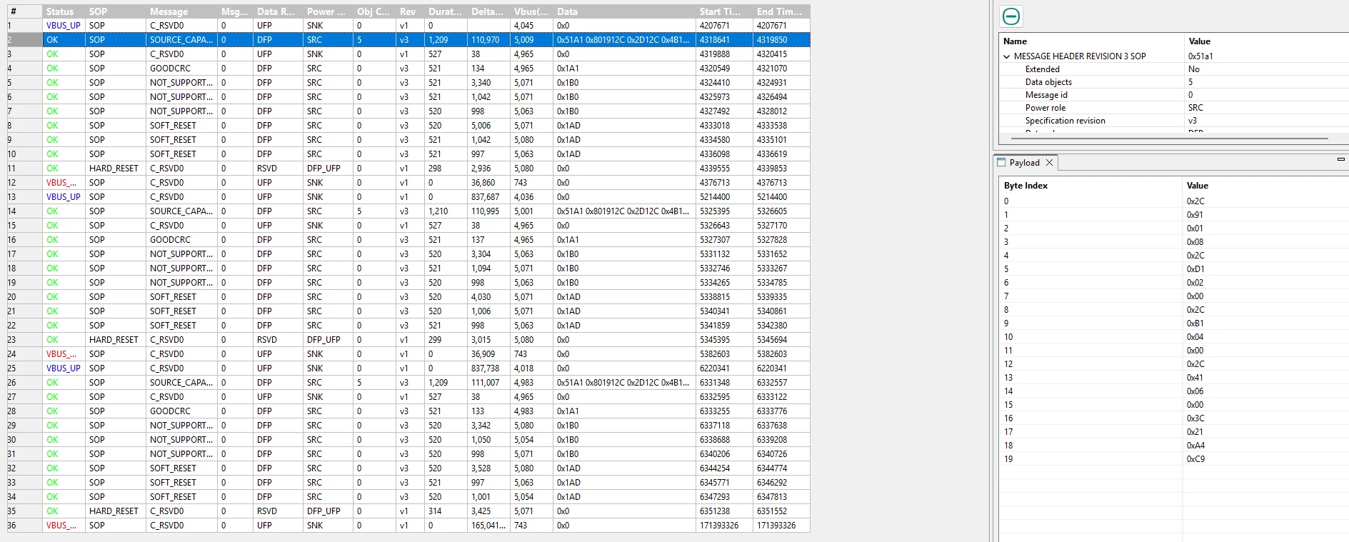

I have attached my trace file (although it may not be what you are requesting, I generated this .txt file from the STM32CubeMonitor UCPD). If it isn't what you are looking for, let me know.
I likely won't be able to give you the whole project but I may be able to give you particular files or screenshots of some of the code. Are there any particular files that would be useful for you?

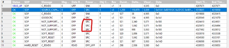

The source sends its capabilities. However, your sink device sends NOT_SUPPORTED messages and initiates SOFT_RESET. Check your sink PDOs list. The sink device is not properly handling the received SRC_CAP.

Just double checking, is the NOT_SUPPORTED from the Sink or the Source? It looks to me like it is coming from the Source:

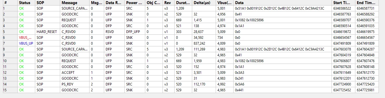

Awhile back I was able to get the USBPD_DRP_UX_DRD_HID (uses ThreadX) example working with the STM32H573I-DK and this is what the sequence looked like:
Can see that after SRC sends its capabilities the SNK (dev kit) sends a GOODCRC. Whereas on my board it just sends 0x0 back (one tool called this a C_RSVD0 message and the other called it an Unknown_CONTROL_ID message).
Regardless if my board couldn't support the capability, shouldn't it follow the Source's capabilities with a GOODCRC message?
