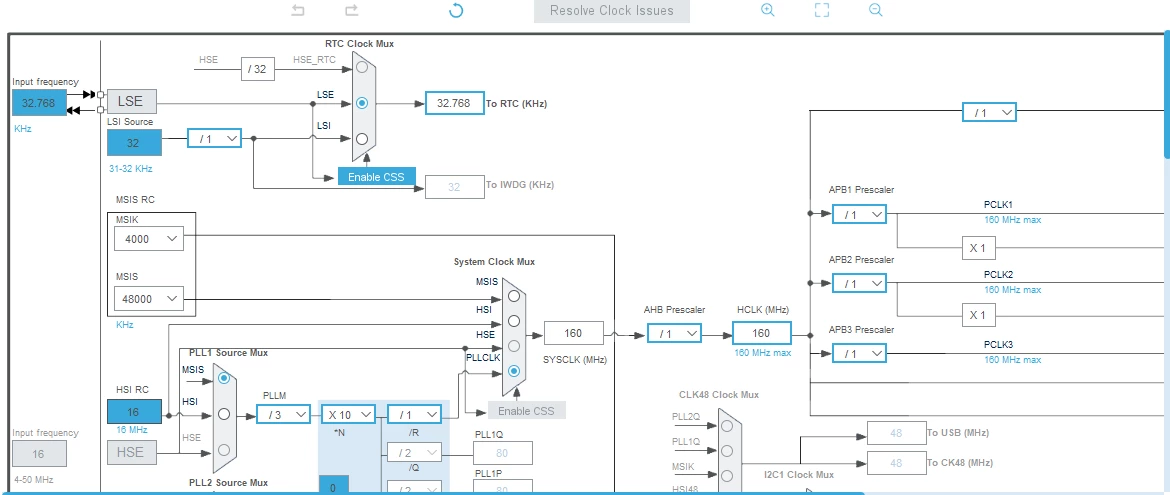

 its an RTC alarm not RTC Timer wakeup ?  like this?
(HAL_RTCEx_SetWakeUpTimer_IT(&hrtc, 0, RTC_WAKEUPCLOCK_RTCCLK_DIV16, 0)
Aug 1, 2025 10:55 AM UTC
Hello @shivss
Are you using the LSE as RTC clock source ?
According to the reference manual the RTC remain active only when the RTC clock source is LSE.
In order to give better visibility on the answered topics, please click on 'Best answer' on the reply which solved your issue or answered your question. Saket_Om
shivssAuthor
Aug 4, 2025 8:40 AM UTC
 yes am using LSE
