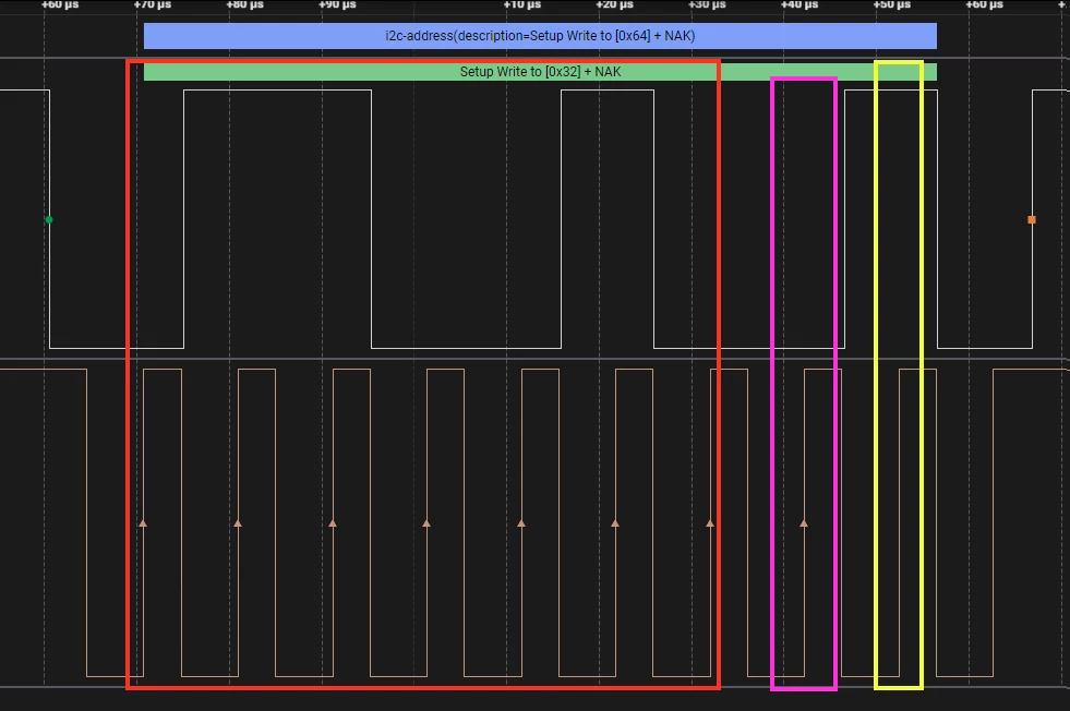

I put a logic analyzer on the SDA and SCL channels and I can confirm the slave really doesn't send the expected ACK:
In the yellow region the SDA should be pulled low.

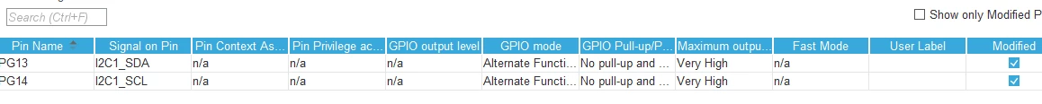

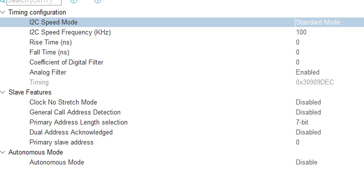

The CubeMX config:
Both are set to 'open drain' as they should be.
Just to try I made a little scan over all 128 I2C addresses, but I don't get an acknowledgement anywhere. I've also tried about all possible I2C configurations, but to no avail.

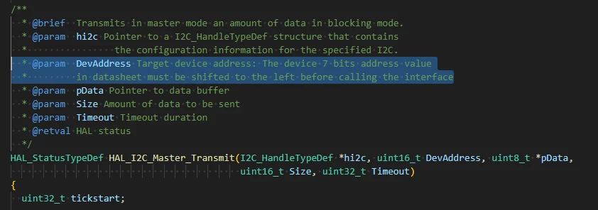

I feel silly because the docblock clearly states this:
I figured this out because I was looking at the logic analyzer during the address scan and I saw each address scroll by twice (e.g. 0x00, 0x00, 0x01, 0x01, etc.) instead of incrementing each time.
