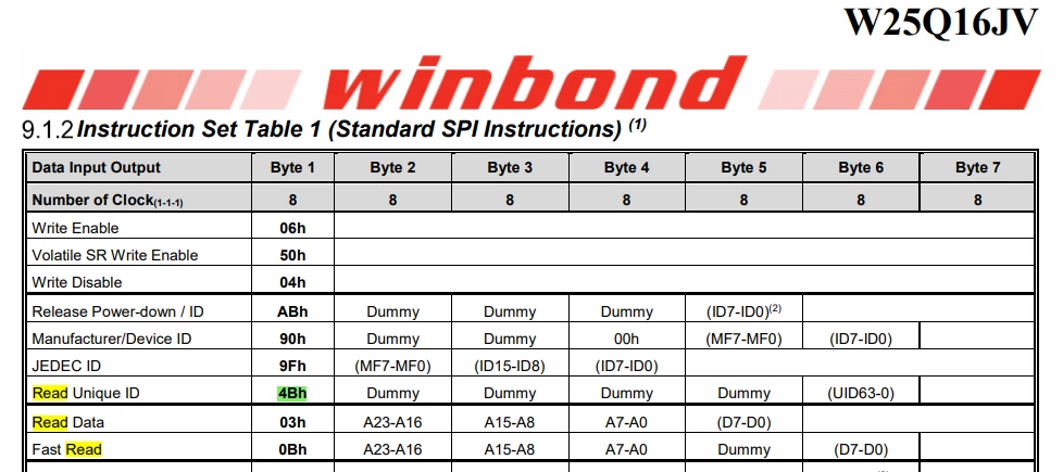

hello,
W25Q16JVZPIQ this is flash memory i am interfacing with stm32u575rit6.. I configure QSPI driver generated for ospi.  can you give any example to get device id.

Example of READID command dispatch on STM32U5 OCTOSPI to QSPI Winbond / Micron / Macronix NOR Flash devices.  https://github.com/cturvey/stm32extldr/blob/main/ospi_qspi_readid.c
