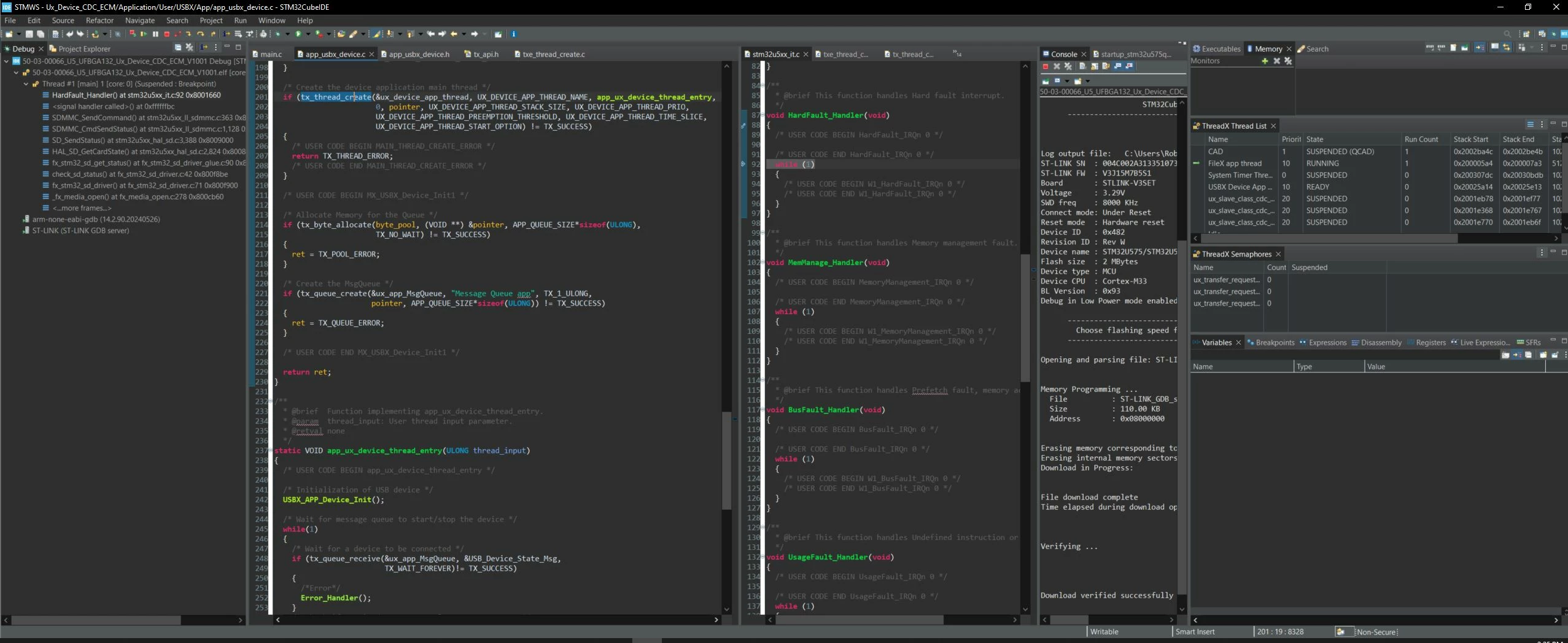

Debug findings:
1) 'app_usbx_device.c' line 201 'if (tx_thread_create...' haven't load 'USBX_APP_Device_Init()'
2) ' _tx_thread_schedule();' run into 'void HardFault_Handler(void)' loop which is from 'tx_thread_schedule.s --> __tx_wait_here:'
I don't understand some of the updates on the 'user code' part, and I can't find an example or documentation to explain this. Should I copy all drivers or do something else? I would appreciate it if you could provide application notes, check my attached project, and help me with this.
