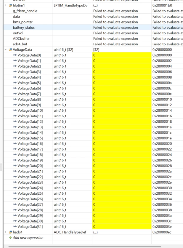

I create LBPAM application which continuously convert ADC4 data channel 22 (PC4) of STM32U575 VGTX.
I add HAL_DBGMCU_EnableDBGStopMode(); so I can debug in stop mode. I run LPTIM1 and ADC4 before going to STOP mode. I also move VoltageData buffer to SRAM4 uint16_t VoltageData[32] __attribute__((section(".sram4")));
LPBAM configuration contains one queue in Circular mode and only one node for ADC4 conversion.
After enter stop mode 2, no adc4 trigger, and VoltageData always is 0.

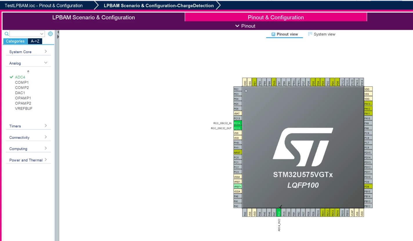

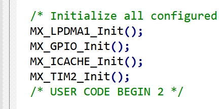

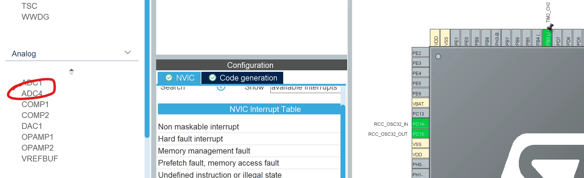

The posted code doesn't use ADC4 at all as far as I can tell. No MX_ADC4_Init call. No other calls in main().
In the IOC file, ADC4 is not enabled.
Am I missing it somewhere?

@TDK I configure ADC4 in LPBAM configuration.
I run ADC4 in MX_ADC4_Init() (LPBAM/ChargeDetection/lpbam_chargedetection_volmealoop_config.c)
