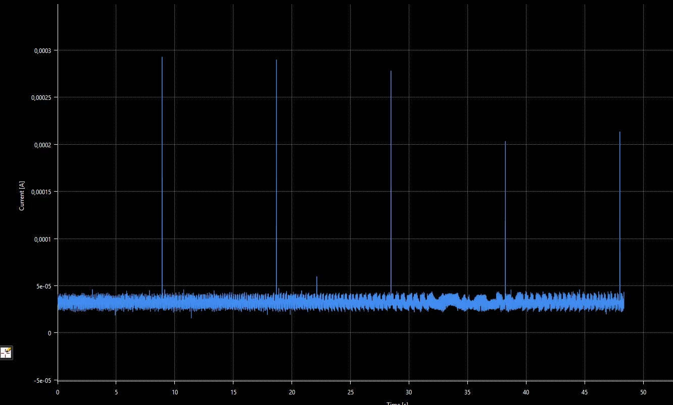

Seems to be working, but my current consumption is around 30uA, when the datasheet says it should be around 3 or 4uA. Do you know what can be causing such high consumption?

Hello @JPortilha ,
Glad to hear that the default task is now running correctly. Your RTC/semaphore flow looks much closer to working as expected. If the LED is toggling properly but the current consumption is still high, I would suspect one of two things:
  1. The device is not actually spending most of its time in STOP2, or
  2. The current measurement is including board-level consumption rather than only the MCU supply path.
A few points are worth checking:
  •  Look for any other interrupt source that may be waking the MCU periodically before the RTC wakeup expires.
    Even if the RTC path is correct, another timer, HAL timebase source, UART activity, EXTI interrupt, or debug-related wakeup can bring the core out of STOP2 often enough to keep the average current high.
  • Keeping PostSleepProcessing() minimal is still the right approach. Restoring the clocks and resuming the HAL tick there is fine. However, it is better NOT to stop or deactivate the RTC wakeup timer in PostSleepProcessing(), since that function runs after any wakeup source, not only the RTC wakeup.
  • The measurement setup matters on a NUCLEO board. In our low-power examples, we explicitly recommend measuring through the target current path and avoiding normal debug mode when performing low-power current measurements.
So, at this stage I would mainly check for a periodic wake source and confirm the current is being measured on the MCU supply path only, not the full NUCLEO board path.

Hello, I have analyzed the PCB layout (using the CAD documentation provided by the ST), and I am measuring the current using an external power supply with measuring capabilities (SMU). I have removed the JP5 and JP4 of NUCELO-U545RE-Q and I am supplying through JP5 pin 1. According to the layout on Altium, this pin will only supply the MCU, so I think that part should be ok. I have added prints for debugging and the system seems to only be entering and exiting the low power states every 10 seconds (driven by RTC). I have also added this line after peripheral init to disable the debugger
HAL_DBGMCU_DisableDBGStopMode();
I can leave a print of my current measurement, but according to datasheet STOP2 mode with RTC at 3.3V should be around 3.5uA.
