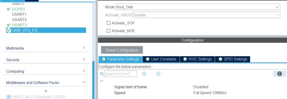

I try to migrate the  UX_Host_HID example on STM32U575I-EV to nucleo-u575zi-q.
STM32CubeIDE Version: 1.17.0
STM32CubeMX Version: 6.13.0

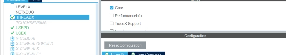

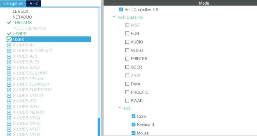

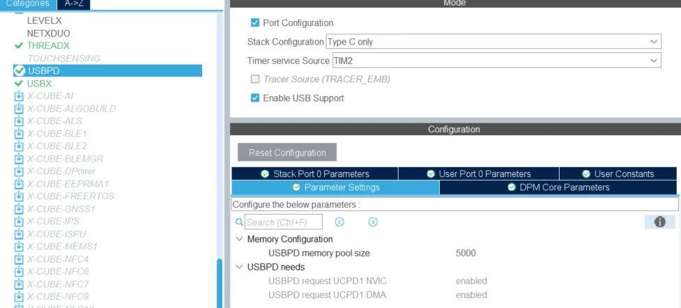

I duplicate all the settings relating to USB host options to mine.

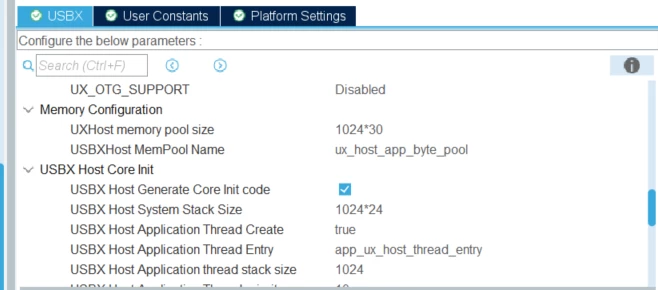

In the middleware:

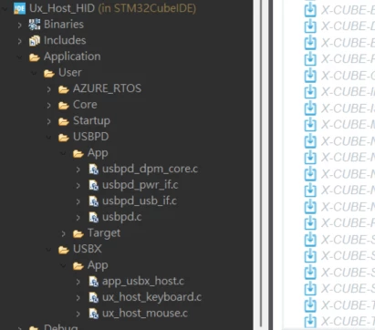

and then copy the source code from the Ux_Host_HID

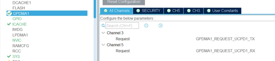

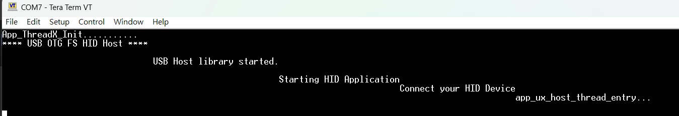

After programming the firmware to my ev board, i plug the hid device to the CN15 USB connector. There is noting happened and no power react on my hid device.
Did i miss any settings to setup the USB host example??
how can i provide power to the hid device???

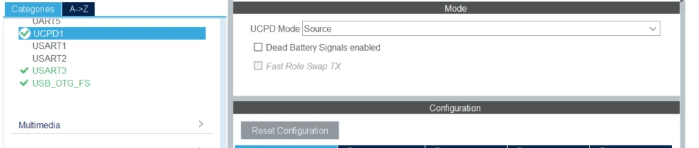

Hi @tommyliu
It is an expected behavior. VBUS should be powered by the USB Host and the Nucleo-144 U575 board works as a USB Device. However, the eval board can work as usb host or device. Refer to section 7.13.1 Description in UM2854 and section 6.11 USB Type-C® FS/HS in UM2861 for more details.
To give better visibility on the answered topics, please click on "Best answer" on the reply which solved your issue or answered your question.Best regards,FBL
