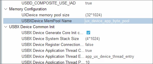

I had to reduce the UX_Slave_Request_Data_memory to 512 from 2048 to avoid crashing, even though I increased the UX Device mempool size to 32K in an attempt to stop crashing when using 2048, which did not resolve. The demo code uses 16K and 512.
In the code:
#define USE_STATIC_ALLOCATION 1
#define TX_APP_MEM_POOL_SIZE 1024
#define UX_DEVICE_APP_MEM_POOL_SIZE 32768
#define USBPD_DEVICE_APP_MEM_POOL_SIZE 5000
I checked the byte pool memory, and it reported no error. I'm familiar with Azure ThreadX.
PS: I have attached the IOC file from the previous comment.

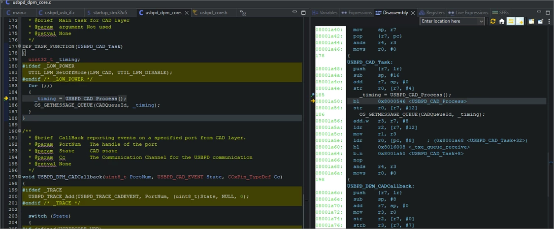

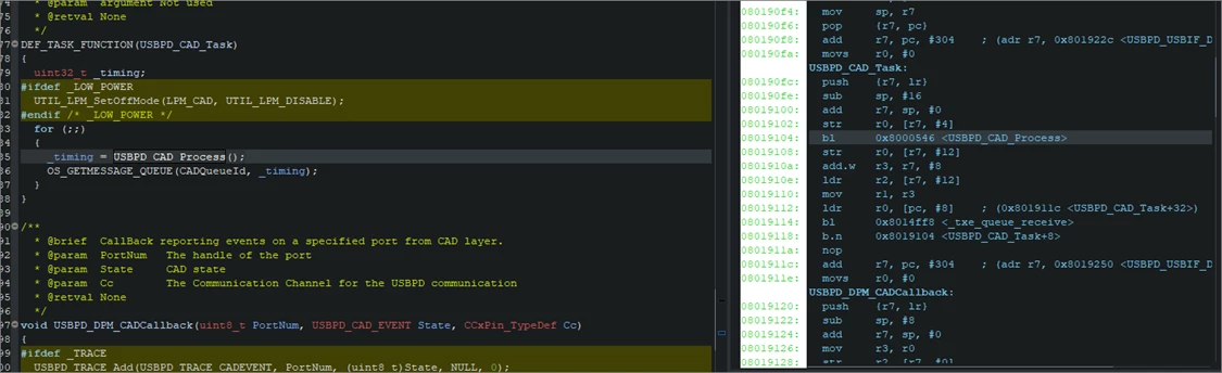

The above is the working demo code (2021) with a breakpoint to check USBPD_CAD_Process(); I found no source code for this function. The callback is working fine.
Below is the issue code (2024) with the same breakpoint as above; the callback is implemented but not run. I don't know what is happening in USBPD_CAD_Process() or why it is not calling a callback. The callback was implemented by the init code (from CubeMX), and the demo code was copied (2021).
Because I don't know what in USBPD_CAD_Process(), do they run callback? what makes it work for the callback code to be executed?

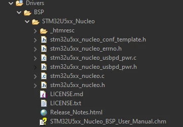

I found my way here while having similar problems with STM32U575ZI Nucleo.  I learn some things so I wanted to post it in case it helps someone else.    I have a custom board that has the same USB-C HW setup I copied directly from the Nucleo Altium files.  I could not get the USB to work on either my custom board or the Nucleo if I started my own project from scratch using STM32CubeMX (R6.11.0 and FW_U5V1.50).  I had the same problem USBPD_DPM_CADCallback(..) would not fire.   It did however work fine if I used the demo code (UX_Device_CDC_ACM) - this was true on either board... even though my custom board has the VI package not the ZI.  I wasted a ton of time tracking down the solution and here is what worked for me.  For some reason just adding the BSP files from the demo project to mine made the callback fire!!!  You don't have to include or call anything they just need to be there.
You may need to rename stm32u5xx_nucleo_conf_template.h" to stm32u5xx_nucleo_conf.h"
After finding that worked.  I found that the functions from this library are called in usbpd_cad_hw_if.c however even if they are not in the project it doesn't generate any errors. Also, they are not included anywhere.  SO, I went further and pulled out only the stuff from the BSP that made it work and added it to the project.  I was then able to remove the BSP folder and it still works!!!.   For some reason just having this stuff in your project makes the callback fire.  See attached files with just the stuff you need from the BSP library.

The technical reason for the problem is that the callbacks in usbpd_pwr_user.c (generated by STM32CubeMX) are declared __weak and is therefore overridden by the same callbacks declared in stm32u5xx_nucleo_usbpd_pwr.c (without the __weak keyword).
