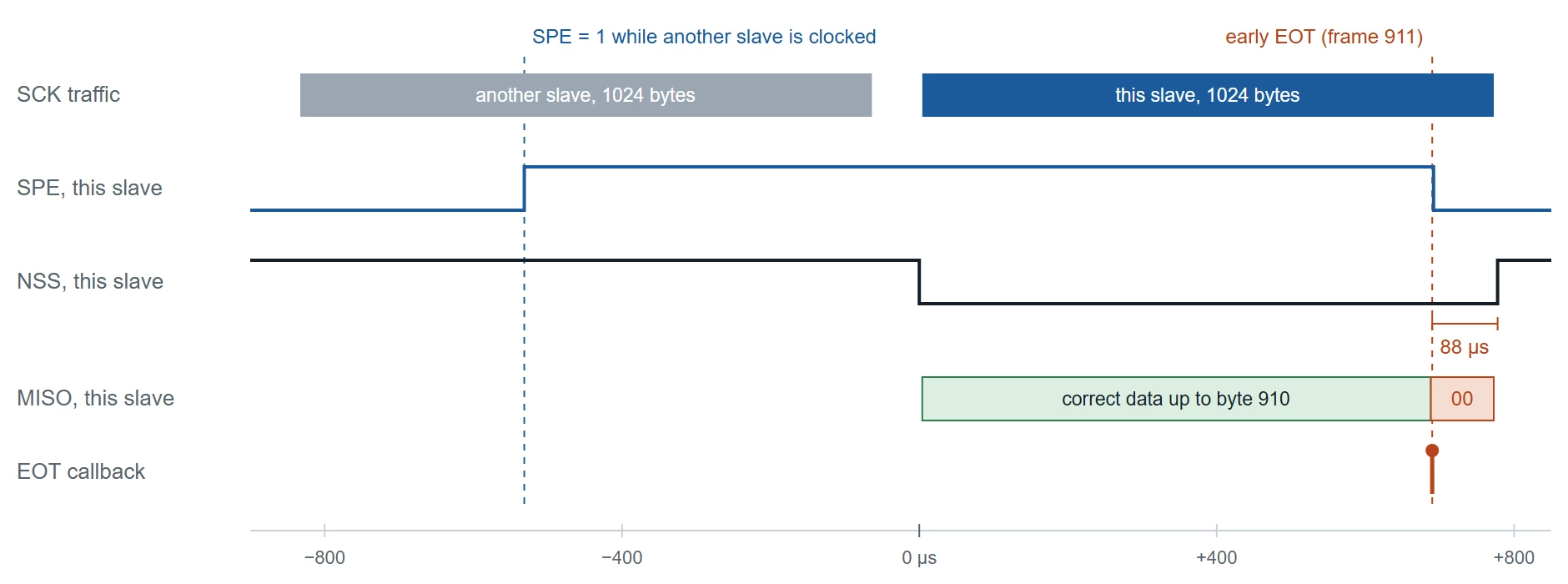

on a shared SPI bus (one master, several slaves, one NSS line per slave, the "Standard multislave communication" topology of RM0456 §68.4.5), an STM32U5 SPI slave with hardware NSS sometimes ends a transaction early. EOT is raised 112 or 126 bytes (frames) before TSIZE, with no UDR, OVR, MODF or FRE flag. The slave then stops driving MISO, so the master receives the last ~110 bytes as 0x00, while on the slave the HAL reports a normal "transfer complete". The data corruption is silent.

Each slave prepares its next transfer on its own, with HAL_SPI_TransmitReceive_DMA, which sets SPE as its last step, and then raises a "ready" GPIO for the master. So the call sometimes falls while the master is clocking another slave: this slave's NSS is high and SCK is toggling. That is the only case in which the failure appears.
  • With only one slave active (no foreign traffic on SCK) it never happens.
  • It is the instant SPE is set that matters, not the DMA setup. Our workaround: prepare the transfer as the HAL does but without SPE, wait for ~2 µs of idle SCK, set SPE, check SCK again (abort and retry if it moved), and only then raise "ready". With it we saw 0 failures in more than one million transactions.

Figure 1 is a logic analyzer capture of a failing transaction [A]: SPE is set during another slave's transfer, and this slave's own transfer then stops at byte 911 of 1024.

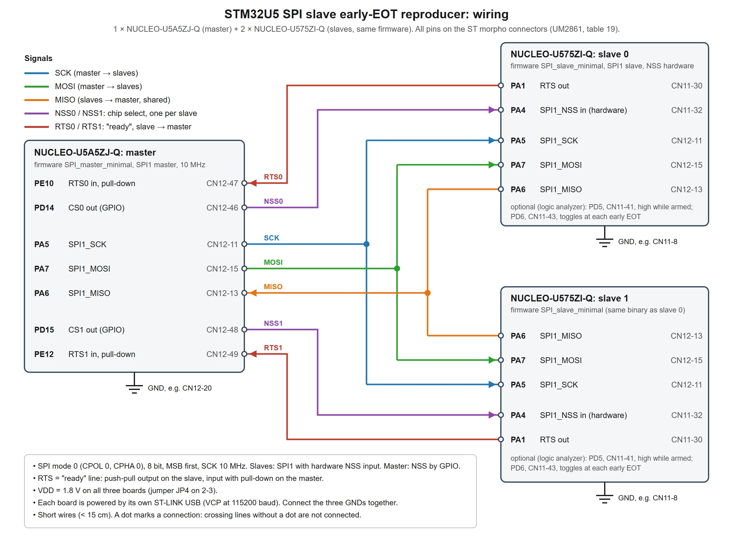

Reproduction on NUCLEO boards (projects attached)
  • Slaves: 2 × NUCLEO-U575ZI-Q, STM32U575 revision X (DBGMCU_IDCODE 0x20016482), same firmware (SPI_slave_minimal). SYSCLK 128 MHz from HSI16. SPI1 slave, 8 bit, mode 0, hardware NSS on PA4, FIFO threshold 1, GPDMA1 ch14 TX / ch15 RX. Every 2 ms: HAL_SPI_TransmitReceive_DMA of 1024 bytes (byte i = i), then the ready GPIO goes high.
  • Master: NUCLEO-U5A5ZJ-Q (SPI_master_minimal). SPI1 master mode 0 at 10 MHz, NSS by GPIO (one per slave), bytes back to back. It serves the slave whose ready line is high and checks every received block.
  • VDD = 1.8 V on all three boards (JP4 on [2-3]). Wiring in figure 2.
  • STM32CubeMX 6.18.1, STM32CubeU5 1.9.0, STM32CubeIDE (Debug configuration).

How to run
  1. Import both projects in STM32CubeIDE, build, flash SPI_master_minimal to the NUCLEO-U5A5ZJ-Q and SPI_slave_minimal to both NUCLEO-U575ZI-Q.
  2. Wire as in figure 2. Start (or reset) the master first, then reset the two slaves, so all counters start clean.
  3. Open the three ST-LINK virtual COM ports at 115200 baud. Each board prints one line per second. The firmware labels are in Italian:
    • slave: blocchi 70332 errori 134 (resto 96) errori_hal 0 arming_falliti 0 means transactions, early EOTs, TX bytes still undelivered at the last early EOT, HAL error callbacks, failed HAL_SPI_TransmitReceive_DMA calls.
    • master: s0 133/70500 (912,112) sf 0 | s1 179/71800 (898,126) sf 0 | hal 0 means, per slave, corrupted blocks / blocks, (first wrong byte, number of wrong bytes) of the last corrupted block, blocks after which the slave did not end the transfer; then HAL errors.
  4. Optional, for a logic analyzer: on each slave PD5 (CN11-41) is high while a transfer is armed, and PD6 (CN11-43) toggles at each early EOT.
