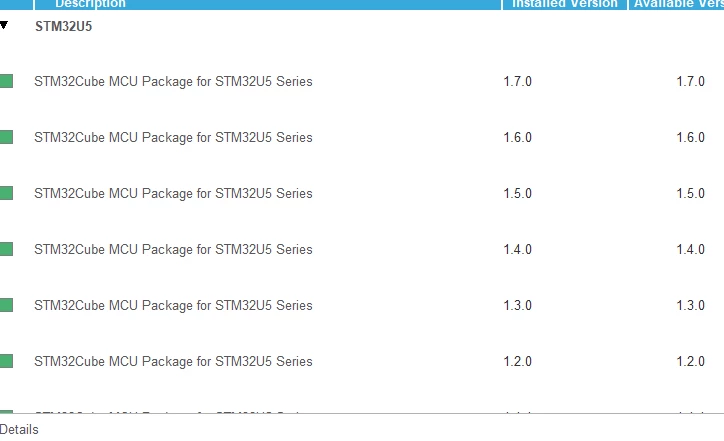

May 29, 2025 12:57 PM UTC
Hello @FBL ,
Is there a way to access this Core MW package from cube MX? Currently under softwrae packs for u5 I cannot see this from cube mx.
FBLBest answer
May 29, 2025 1:17 PM UTC
Hi @nsa
No, this package is exclusively published on GitHub (and is neither available in STM32CubeU5, STM32CubeMX nor available on www.st.com). It contains the integration of the Classic CoreMW stacks with STM32U5 devices, allowing users to get quick access to pre-built projects integrating them.
To give better visibility on the answered topics, please click on "Best answer" on the reply which solved your issue or answered your question.Best regards,FBL
