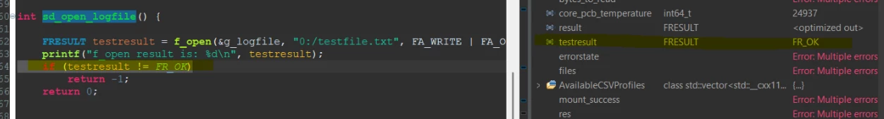

The interface works and I can also kind of work with fatFS, f_mount, f_open works basiclly, but sometimes I got a FR_DISK_ERR. On my scope I can see that the SD clock is always on when the error occures. So I think there is an issue with the low level driver level or better say somethimg is going on with the diskio layer. Please see the attached pictures of working f_mount and f_open and the f_open where the clock doesn't stop.
I'm using FreeRTOS and I have a dedicated SD_Card Task.

@KORKADThanks for the reference. I checked out the FatFs driver implementation for H7RS products. Therefore I downloaded the STM32Cube_FW_H7RS_V1.2.0 and compared the sd_diskio.c implemtation to my own implementation. Basiclly it's more or less the some - despite this fact I used the implementation in en.stm32cubeh7rs-v1-2-0.zip\STM32Cube_FW_H7RS_V1.2.0\Middlewares\Third_Party\FatFs\source\drivers\sd->diskio.c to test this too.
Unfortunally I got the same issue with the never ending clock that appears sometimes. Do you know if the blocking read/write access to the sd card is possible in an own RTOS task. Or should switch to sd_diskio_dma_rtos.c? My preference is the blocking code, if possible.
I appreciate your support hopefully we can fix the issue.

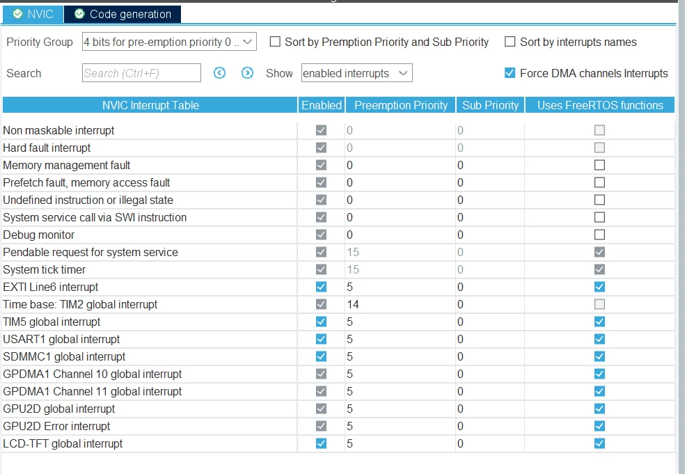

Hello @Julian_
To effectively debug the issue, start by ensuring the SDMMC functions correctly using only HAL. Once confirmed, integrate FATFS and verify its operation. Finally, incorporate FreeRTOS and perform another check.
In order to give better visibility on the answered topics, please click on 'Best answer' on the reply which solved your issue or answered your question. Saket_Om

Julian_Author
May 14, 2025 1:35 PM UTC
@Saket_Om
unfortunally no positive update...
The interrupt priority for sysTick is the highest see .ioc config:
Enabling the interrupts before HAL-Delay has also no influence to the issue:
 HAL_Delay(50); //this delay works
 while (1){
	 // Mount SD card
	 fres = f_mount(&fs, "0", 1);
	 if (fres != FR_OK) {
		 printf("Mount failed: %d\n", fres);
		 //return;
	 printf("Mount successful.\n");
	 __enable_irq(); //no influence on issue
	 HAL_Delay(20); //<-- delay doesnt work
I also disabled UART DMA initalization before the FATfs Test.
In my opinion anything during f_mount is responsible for this behaviour but I don't know what.
Systick source is: systick_source = SYSTICK_CLKSOURCE_HCLK;
Do you have some input how to move on?
Thanks,
Julian
May 14, 2025 1:41 PM UTC
Hello @Julian_
You did check with priorities of Timer (Timer used as time base) interrupts higher (Lower numerically) than SDMMC.
