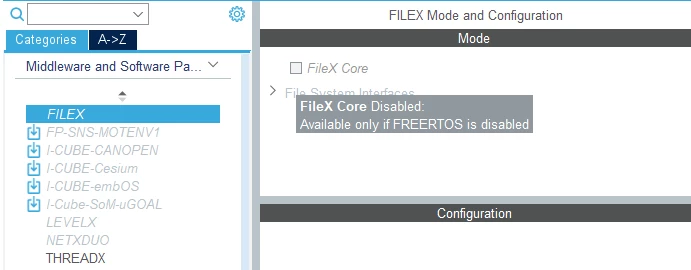

I'm using NucleoU575 with CubeMx and I want to make a file system on my SD card.
I want to use FreeRtos but there are no Fatfs in CubeMx and the FileX cannot work with FreeRtos (image). Is there anyway i can use Fatfs with STM32U5 ?
Thank you.

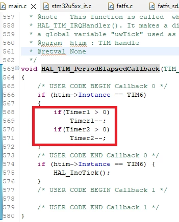

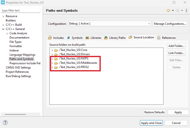

I share my code for the NUCLEO-U575 to everyone who needs in the file attached here.

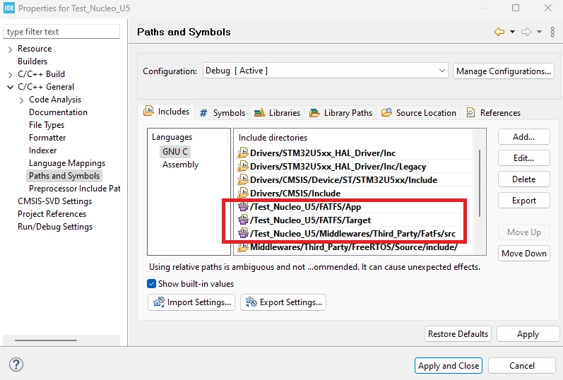

1/ I used this SPI driver for the sd card : https://www.micropeta.com/video29
2/ I copied the FATFS files from a CubeMX project for STM32F4 then modify to the U5
_legacyfs_online_stmicro_images_0693W00000bkUWCQA2.pngI also need these two files from F4:
_legacyfs_online_stmicro_images_0693W00000bkUjGQAU.png3/ You need to add some path to your project (see image)
_legacyfs_online_stmicro_images_0693W00000bkUVsQAM.png4/ Don't forget to add this if you use the same SPI driver as mine. You also need the change SPI_FLAG_TXE to SPI_FLAG_TXP in "fatfs_sd.c"

Mar 3, 2024 10:57 PM UTC
Use ThreadX RTOS instead. You can then enable FileX normally.
